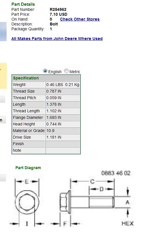

My tractor is 45 miles away at my farm. Can anyone tell me the wheel nut sizes (wheel to hub and dish to wheel) so that I can take correct hardware with me next trip to do the 10 hour torque check? Also, are they metric or English sizes. Another member advised a 12 inch extension and 1 inch diameter drive. Will a 3/4 inch drive deliver 400 ft-lbs? Also the same info for 553 loader bolts. I believe there are 7 bolts per side on loader.

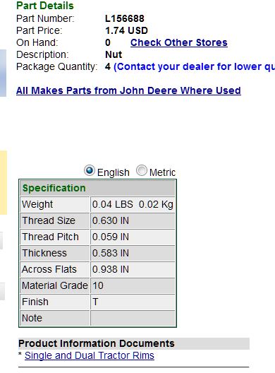

Here's some spec's on the rear wheel hardware.

No, not larger. Rear wheel disc to axle 30mm. disc to wheel 24mm. Front disc to axle also 24mm.

You will only need 24mm and 30mm sockets. Fronts are 24mm, disc to hub and disc to wheel. Rears are 24mm disc to wheel and 30mm disc to axle.

Completed re-torquing wheel nuts and 553 loader bolts last Friday after 10 hrs on new 5065e. None of the wheel nuts were loose. However, all 4 (per side) of the 30mm rear bolts needed tightening. The bolts rotated about 90 degrees. Of the 3 (per side) smaller, front (24mm) bolts, 1 needed tightening on one side and 2 on the other. I used a 3/4 inch drive torque wrench good to 600 ft-lbs. The 30mm loader bolts require 400. In order to get the socket on the upper bolt of lower pair, on left side of tractor, I had to remove the step. Required removing about 8 bolts. I used a 1 3/16", 6 sided socket vs 30mm. It fits within 0.006" (larger ). Glad I checked bolts and nuts. I marked the loader bolts with black Sharpie permanent marker. If they rotate I will be able to tell visually.
