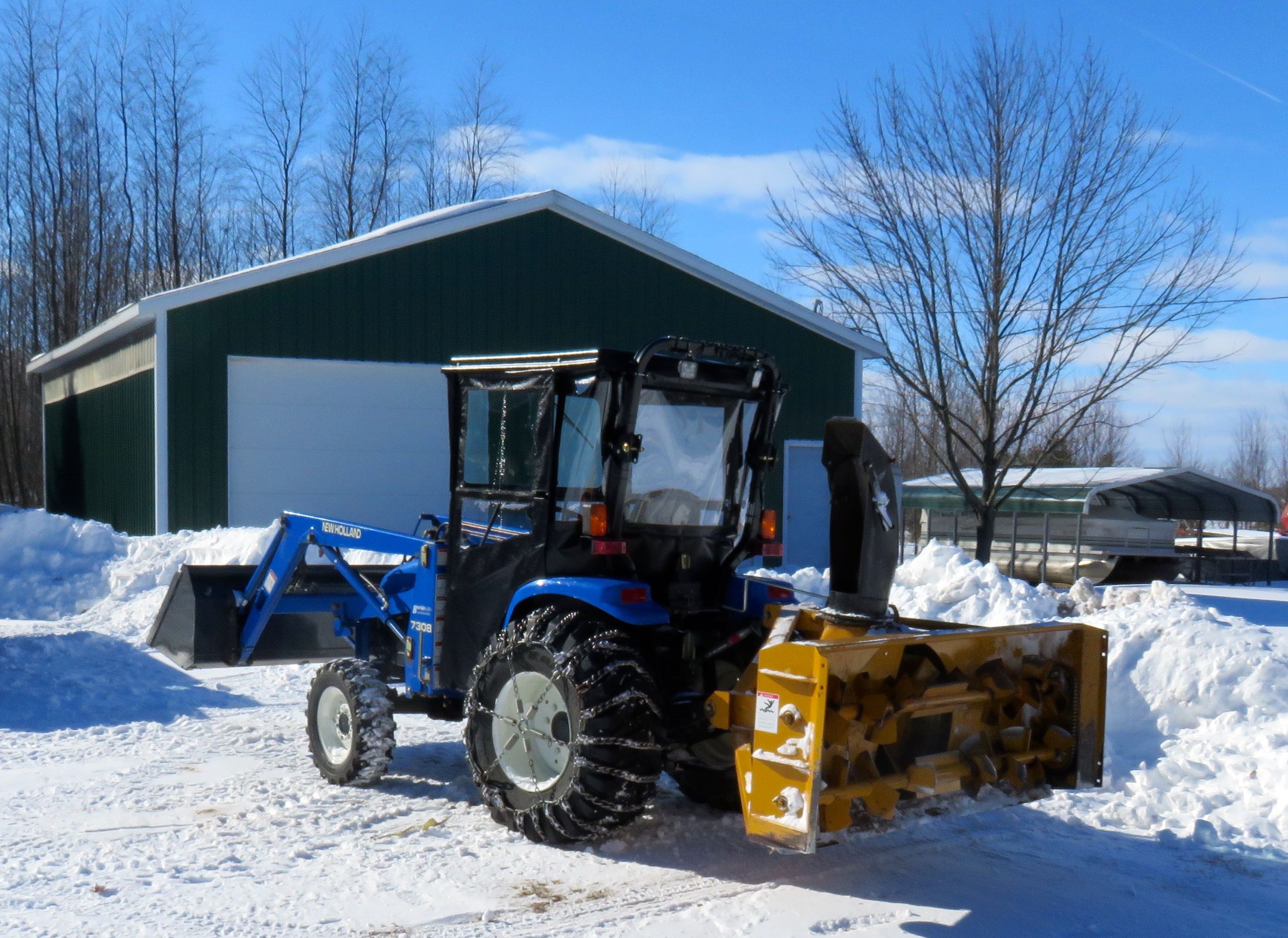

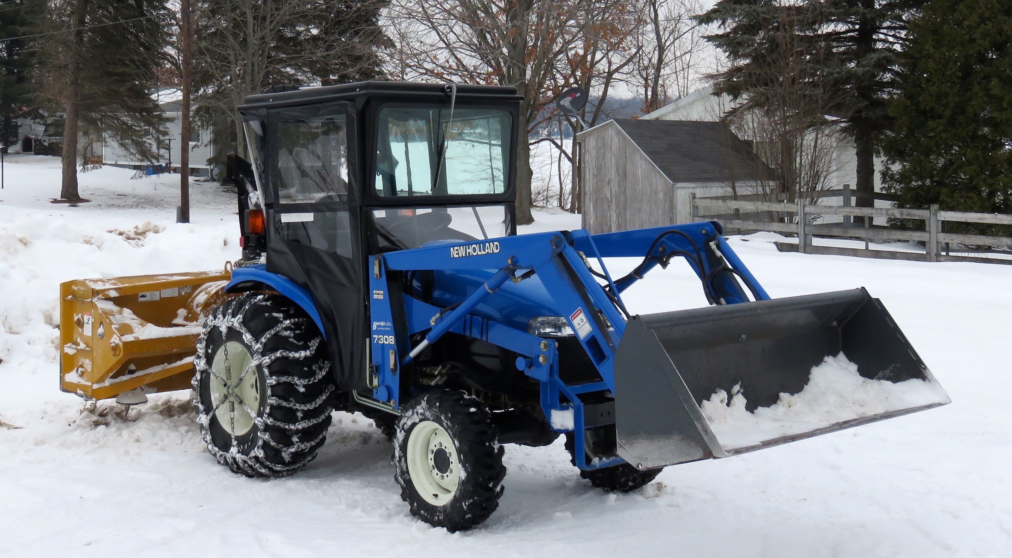

/ Soft cab #28
I've been to the website and even called them. For my tc30 and related models they won't sell directly. Have to order through new holland.
Here's a couple pics of an OTC cab I purchased from NH this year for my TC33D - I think your TC30 may take a different model cab. OTC was willing to sell direct to me but it would have cost an additional $100 for shipping - if you buy it from NH shipping is free to their dealer. It cost nearly $1600 with tax which seems a bit pricy but it appears well made and was a good fit with no drilling or other mods to the tractor. Glass windshield and manual wiper were standard. It went on easy with only myself and I plan to take it off in the spring and put it back on in the fall. I have 2 gripes - the mounting brackets for the top need to be a little more adjustable and I'll deal with that in the spring - also some of the attachment points use tie on ribbons in places that are difficult to get to - I'll probably go to tie wraps next fall. It's not air tight but is a huge improvement not sitting out in the wind. If a strong wind blows snow from the blower back on the cab some will find it's way in but not enough to cause a problem. I think a rearview mirror - possibly inside the cab - would be handy. I wish I would have gotten the cab 13 years ago when I bought the tractor.

Nice looking blower. That fan must shoot the snow into the next zipcode.
