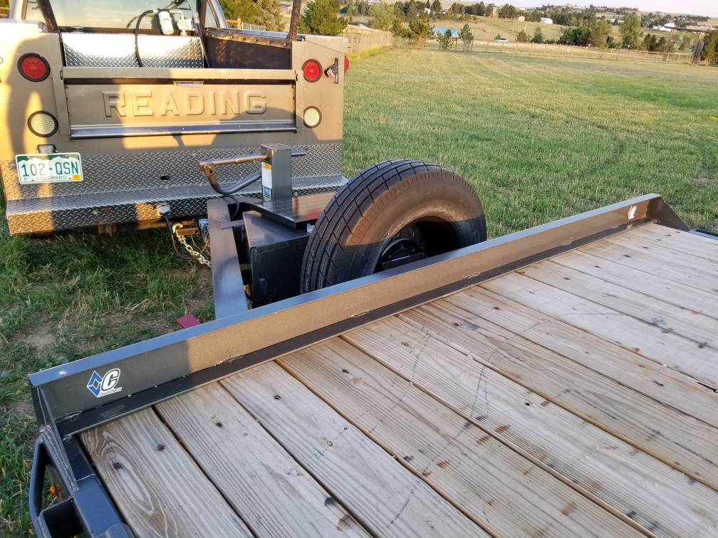

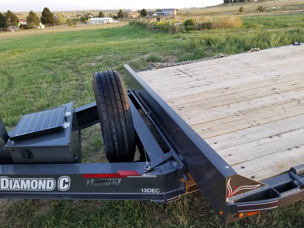

I'll 2nd that. I got mine with the 20@ pannel not 5 though. I ended up using a different 20@ panel to fit on the tongue box on my deckover power tilt. I've never plugged that trailer in for the 2 years I've owned it. Solar keeps it topped up & charged. I'm sure the truck charges it a bit as well, but it's not hooked up that often.
Plenty of potential shading issues on my setup, but it's never been enough of an issue for me to bother caring.
A small wattage pannel with no controller can still do bad things to a battery. Open circuit voltage can get over 18v. Also, a plain pannel will drain a battery at night. You need a diode in the circuit. That diode will cause voltage loss making the battery much less likely to charge fully due to less volts & amps making it through. You are MUCH better off with a smart charge controller to get the right voltage in at the right time.20180806_193217.jpg20180806_193221.jpg
