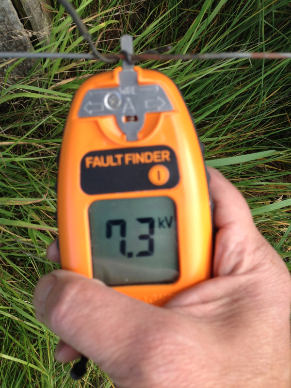

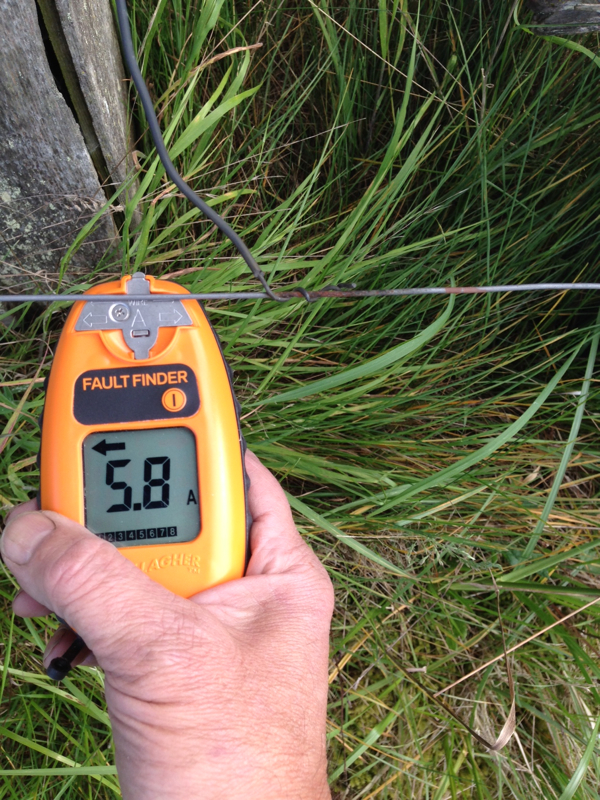

I was able to spend a short time with the new meter today, and is this thing handy or what? Nice not to have to stick the probe in the ground too. I moved a few cows into a field with lots of tall green grass against the fence so I knew I would have lots of draw but with lots of green grass I don't have to worry about the cows getting out anyway. The field is looped and as you can see in my pictures, you can instantly tell how much current is flowing in each direction. The charger is coming in from the wire from the top and goes either left or right (I did not do the joint by the way).
I can't wrap my head around 14.2 amps at 7300 volts.

OK, good info. Here's my take on your numbers....
7400 volts...means fence is NOT badly shorted out at any one place. If it were badly shorted, the VOLTS would drop a lot. Anything over 3000 volts or so is enough to keep your cows where they belong...it really hurts even at that voltage...true, some grass is along the fence and this causes lots of little current leaks resulting in the 14.2 amps total flow. But the voltage remains high. I often see this kind of flow on my fence when grass is growing all along it. If you start at the fencer, likely the amps is a little greater than the 14.2...and as you go along the fence, the current flow will slowly decrease until it is near or at 0.0 at the very end of the fence.
If you find a spot where the flow drops significantly, then back up and locate where the sudden drop happens...right in there is a spot that needs better insulation...or some brush cut down...to reduce the current flow.
I see current flow in the range of 27 amps when I have a direct short...and volts is very low. The total amps a charger can deliver under a direct short depends on the capabilities of the charger. Mine and yours are likely different.
Happy fence fixing!!

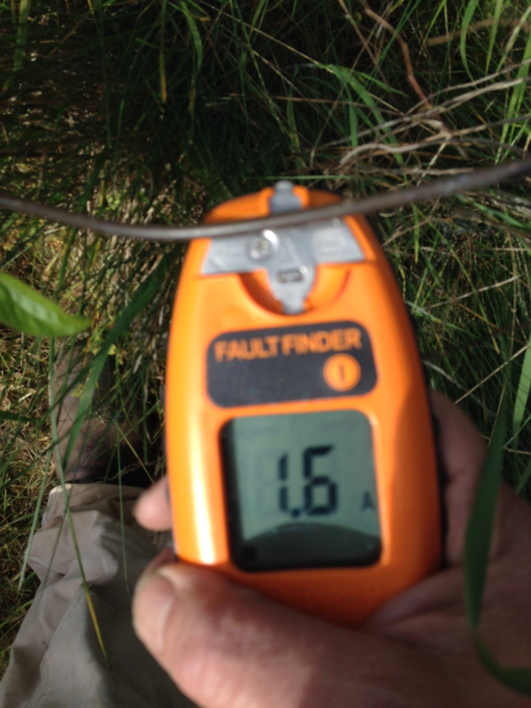

I have 1.6 amps showing on the grounding wire, but no direction. I am thinking the meter may not be designed to show current on the ground wire?
