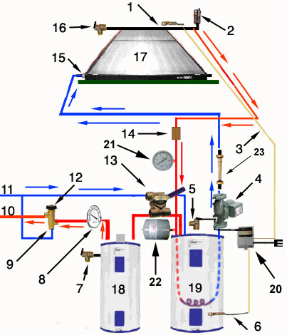

Are you using a "normally open" aquastat at or within the solar panel to controll power to the circ. pump? What temp is that set at?
How many gallons of PEG are used to fill the system? How do you deal with thermal expansion of the PEG? Is the system pressurized?

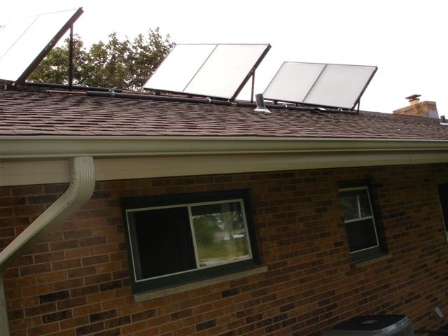

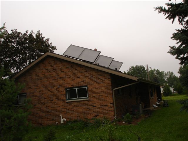

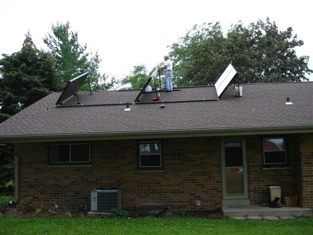

All three panels now installed with some piping.
Bob
It will pay for itself day one. See prior post on financial aspect.
Pump is AC, not sure when it pumps. Something like 10 degree difference. I will ask.
Not sure on how much PEG. 5 gallons???? PEG is cheap. there is an expansion tank. Just like any system with a boiler. I will take a picture.
Bob

I'd like to see the pic of the set-up within the house; showing the circ. pump, anti-syphon, expansion tank, etc. Are you using a heat exchanger external to the HW heater, or did you invest in an indirect HW heater (heat exchanger contained within the tank)?
