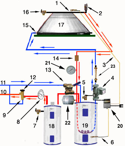

woodlot said:
I'd like to see the pic of the set-up within the house; showing the circ. pump, anti-syphon, expansion tank, etc. Are you using a heat exchanger external to the HW heater, or did you invest in an indirect HW heater (heat exchanger contained within the tank)?
I will post pics soon!
Bob

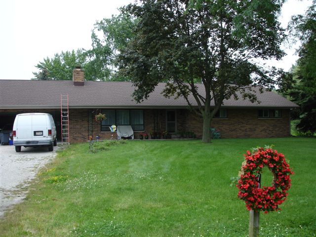

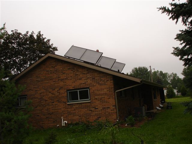

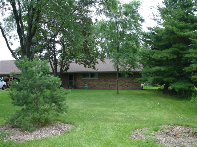

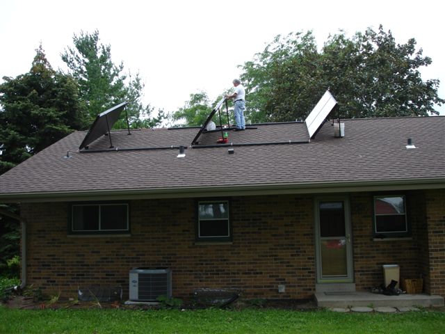

More pics. views from ground. With the trees in leaf, cannot be seen from the road. Three panels 4x8, x3 = 96 sq ft.
Pics from backyard.
Pics from front of house...........
