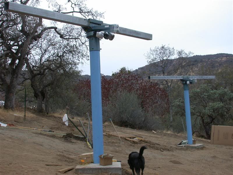

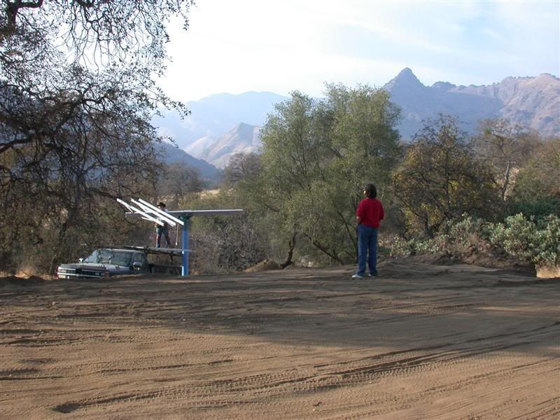

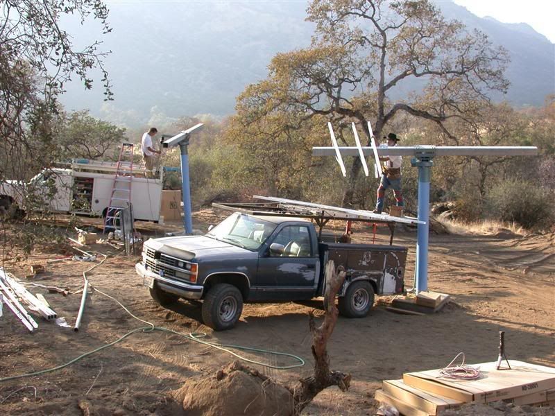

More about the progress out here. The Watsun Trackers were being installed by my solar contractor. Just a few pics and they did not finish before we had to leave. I am going on vacation and won't be back until Thanksgiving, so I'm keeping my fingers crossed that the entire system will be up and running 100% when I get back. Then to figure out what to do with it...:)
Here's Loretta checking it out in the morning.
My dog Coco had to check it out too!

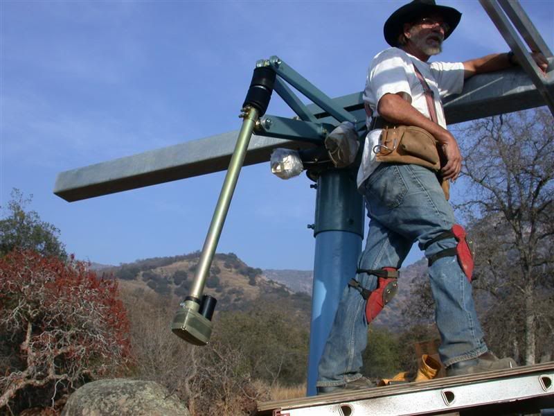

Here is the contractor putting up the frame work that will hold the Sharp modules.
This is the hydraulic arm for the tracking system.
And a close up of the hardware used in the installation.

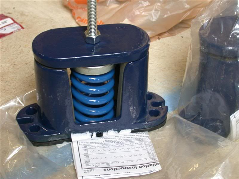

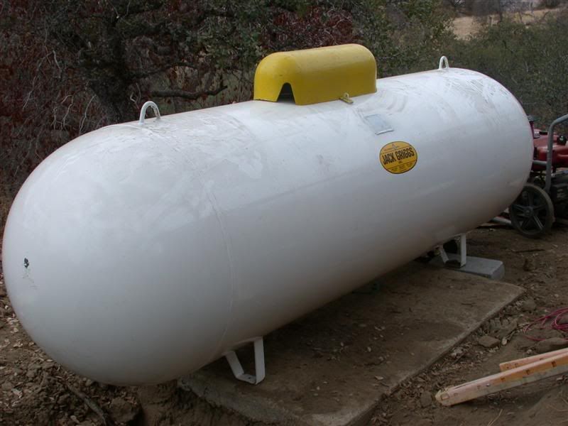

We also got the 500 gallon propane tank delivered but not hooked up yet. This will also take place while I'm gone with the solar contractor and propane guy working together. I will have separate regulators for each of the lines running to the home, the barn/shop, to the generator and also a wet line to fill my BBQ and camp propane bottles now. I still have to pour about another foot of concrete, because the feet on this tank were spread wider apart than the ones we looked at.:confused: But that is not a problem...
We also got the suspension type foot mounts for the generator. This is what they look like.
They are working on all the shed venting and have all the vents painted, but not installed yet. The air vents will open with air draw and circulation and are the "shutter" type. No pics of them but next time ...
wud the wet tap run ya? when i was calling around for propane "bids" for the new house i mentioned a wet tap for my BBQ and you would have thought i asked him to scrafice is first born.
"oh wicked dangerous, really unsafe, way to expensive for the few refils for your BBQ"
then this sat i had to get a refil of my little 20# tank for the furnace on the popup.... $26!!!!!!! (this was after i called fri and propane was $1.60 a gallon :eek: ) so 7$ worth of gas cost me $26!!!!!!!!!
ill be getting a wet tap thankyouverymuch
that and i can convert an old 4cyl toyota pickup to propane for a few hundred bucks (they use the same block in the forklifts) talk about cost savings! :D
   / Solar Power Shed Project
#110
Wet line cost me $20 done with installation. And propane out here is $3.50 at most places! Mine will cost me $1.69 out of my wet line...no driving anywhere too.
