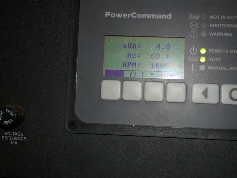

I found out that the generator radiator fan is definitely a "pusher", so all the hot air is being exited to the outside. The contractor put a thermometer in the shed to test how much it heats up with generator running for 1-½ hours. This was done in the after noon. The temperature only rose 2° after the test so this is good enough for to keep the instruments safe. This is a pretty reasonable test because we sized the system to reduce as much generator time as possible, so it may only kick on approximately 30 days out of the year, and for short periods only (we hope). During the Summer months, it may never need to come on except it's weekly self-exercise.
Here is a shot of the generator running, well ... of the power command screen anyway.:)

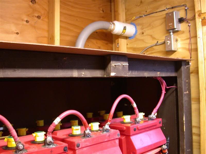

I talked about the power vents on the battery side of the shed. There is one for each bank of batteries. They run constantly to remove any gasses, even though we have 96 of those miser battery caps that traps the vapors. Here is a shot of one of them.

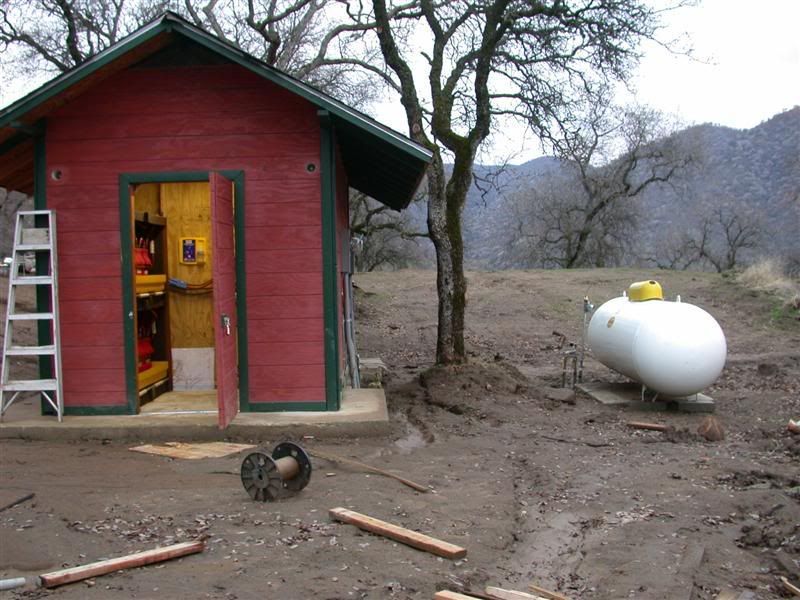

This is a shot before everything was cleaned up around the shed, but shows the lights on and the two power vent exits near the top of each side. Our propane tank is filled and plumbed also. It has lines that run to the house, the barn/shop and the generator. It also has a "wet line" so I can fill up my small propane tanks such as for the bar-b-que and the lanterns at camp.
Our home will be located approximately 150' behind and to the right in that picture. It is a small plateau overlooking the entire valley.

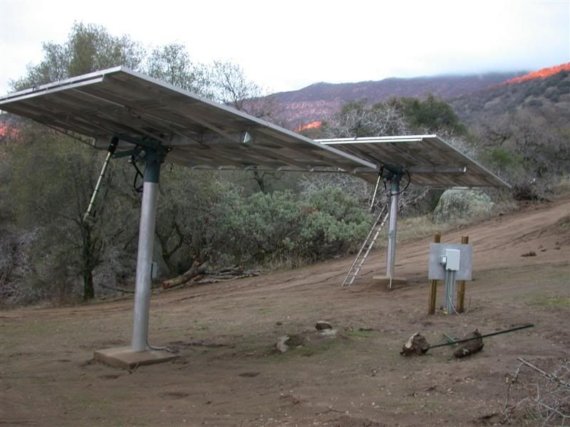

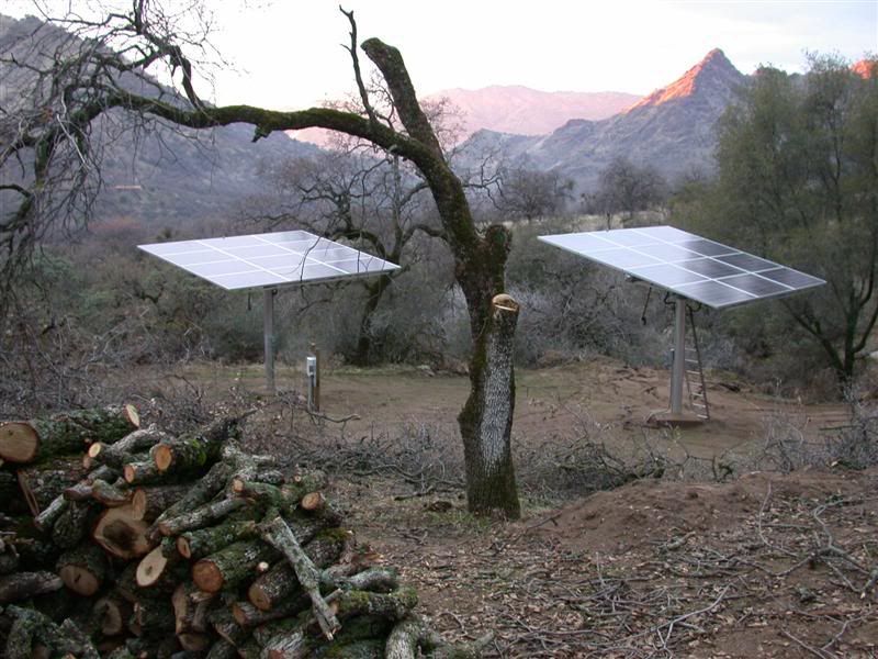

One last set of pictures of the Watsun 225 dual axis Trackers. Here they are "asleep" from the front and rear views. In the background of this first photo, you can see the view we will have from our home, except from a slightly higher elevation. The trackers are approximately 30' lower on an embankment below the homesite.
Also a couple more views to the South and to the East.
Thanks for looking.
   / Solar Power Shed Project #199
Gee Rob...
Better have a chat with your contractor about his drinking habits. Looking at TrackerBackside.jpg, he's got everything tilted to the right. :eek:
