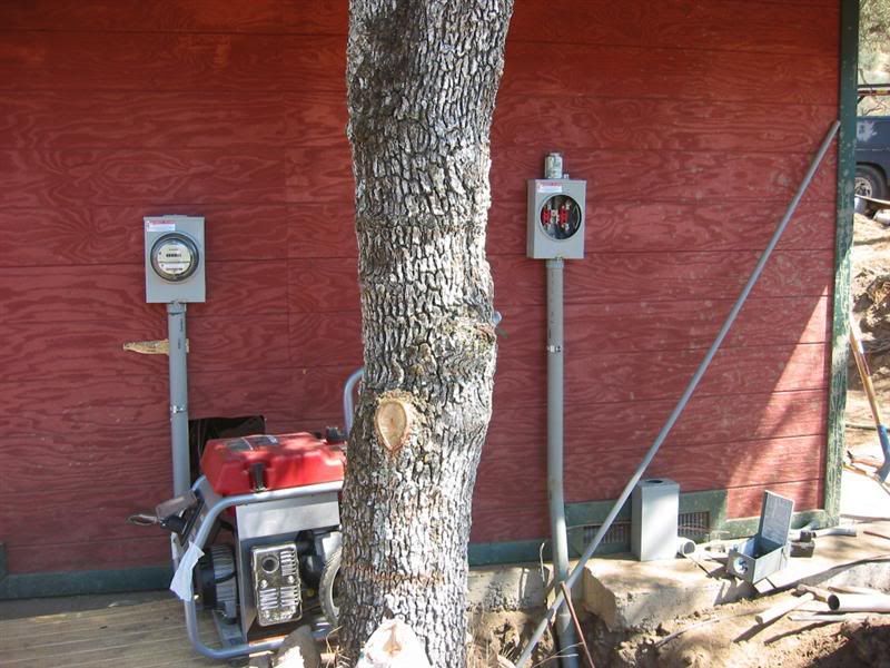

The solar guy charged the batteries with his generator and installed the meter. He has the well hooked up now so the pump starts automatically. No more driving up to the home site to start the generator. There will be 2 meters that show usage, just like if I was on grid. One to power the barn/shop and the other for the house. Except the power being used is what is being made on our own system. I thought that was pretty neat to see the dial spinning. We hope to get the trackers next week and then install them into the ground. Then to mount the solar panels.
Here's a picture of the 2 meters on the shed wall.
This is a close-up of the one running.

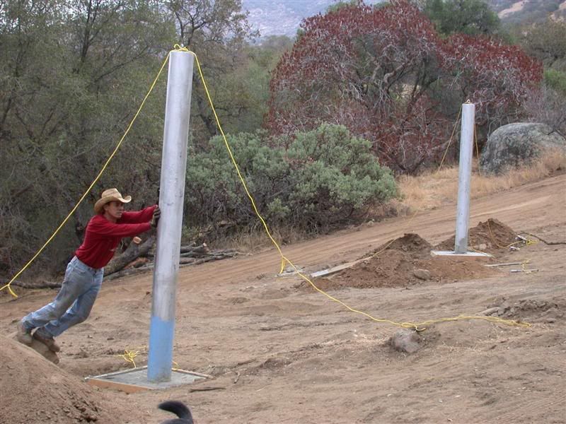

We did get the steel posts into those holes finally. I had to grade a better road and ramp for the concrete truck to get to the meadow where the tracker poles are. It was pretty steep but he managed to get in and out OK. After pouring the concrete, Loretta and I had a chance to have some fun.
Here is Loretta and Coco trying to square up one of the posts. There will be 2 trackers when completed.
Then I had to pitch in the fun too. It was a great break from all the work we did this weekend.

Here are a couple more photos of us having fun. You can tell we had nothing else to do (finally) ;) after completing a bunch of other work on the property. You can also see the slope to the meadow in this picture.
I'm still trying to hold up this post. Man, it takes a long time harden up, I'm getting tired! Now I've got to push it the other way a little.
This is one of them ready to mount the tracker system on. We'll have to paint them first though. Each post is Ø8" and each hole took nearly 3 yards of concrete! The holes ended up about 4' x 4' x 5' deep. Then we poured a "top" on that so it sticks above the ground. Then I can weed-eat around it when the grass comes up. Once the conduit and wires are in place I can level and clean up the area with my Kama.
