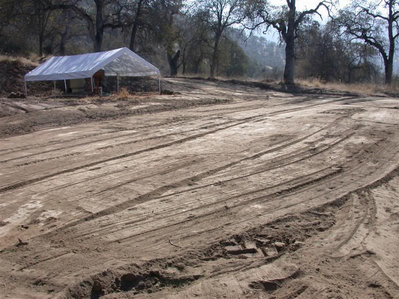

I also cleaned up the tracker meadow. You can see the posts and concrete "tops" that are expose. They are small in comparison to what is holding the posts in.
I also did more grading and clean up on the adjacent site where the well is.

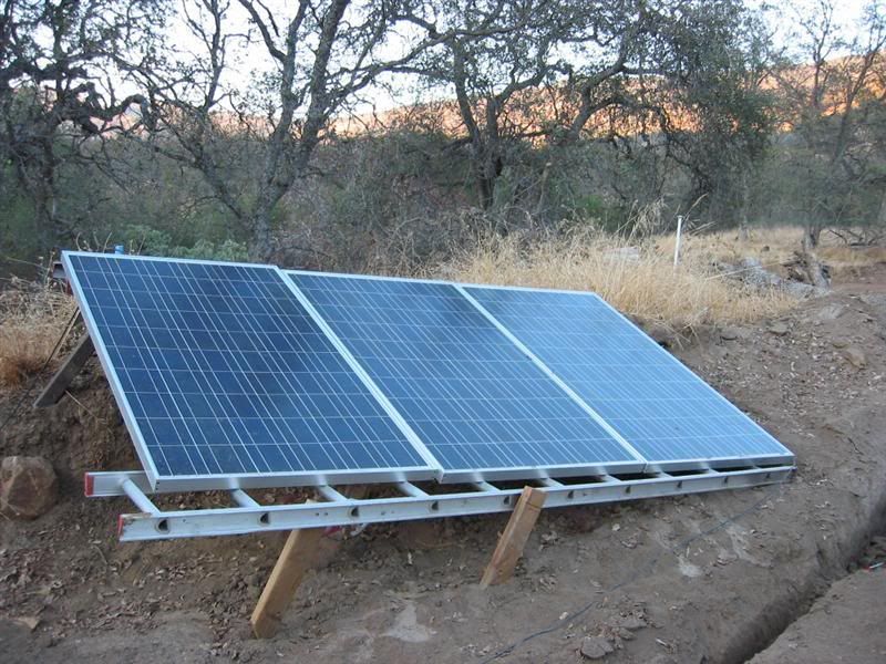

This is where he pulled the power pole for the barn/shop. It will be between the solar power shed and the well.
These are 3 of the 16 Sharp 200 modules. These 3 are hooked up now and are keeping the batteries charged. Since there is no power draw at this time, they keep the batteries full. We are using the system now for charging our 2 way radios, coffee pot, etc. Little things like that.
Just this morning I got a call from Griggs, the propane company who will install the tank next week. Then we can get the generator on line too.
A funny thing happened when the solar guy called for final inspection. The inspectors who are not familiar with "off grid" kept telling him they would need to check the system after the power company hooked up to it. They repeatedly referred to that as he was trying to explain there will be NO power company. This IS the power company. So after it finally sunk in to them, since they had no previous experience with "off grid", they signed off. LOL ... They are now going to let the solar installer help them set up guidelines for final inspection so they have something to "inspect to".
