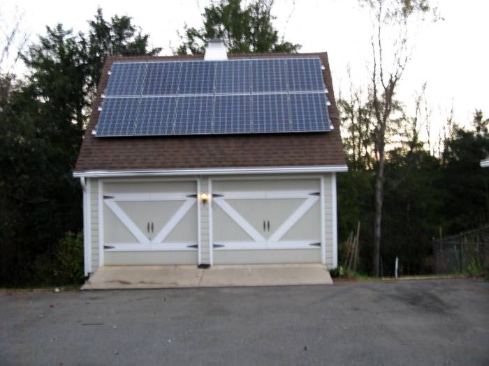

We have a 3 kw solar system in now. Figure it's saving around 600-700 kw on our usage every month via our net meter. The stupid meter doesn't show this. Think it retains a credit for a short period, which is usually erased during the night. First 2 or 3 bills so far have been less in kw but don't seem to be that much less in $.
Ralph
