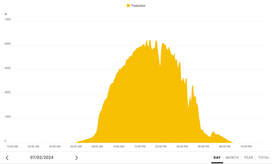

Consider also that while a panel may be, for example, a 350W panel, you may or may not spec the inverters (microinverters these days) to the same maximum.
I have 10kW of DC (panel maximum output) but my microinverters will put out a maximum of 7.68kW AC. The microinverters will unlikely degrade at the same rate as the panels, and the panels will only put out their rated maxima at very specific conditions (angle of incidence of the rays, temperature) and it was explained to me that while I could potentially end up with a few more AC watts in the first few years of operation, the extra cost for higher output microinverters would never come close to being paid off.
In other words - don't think your 10kW of panels all added up together will give you 10kW.

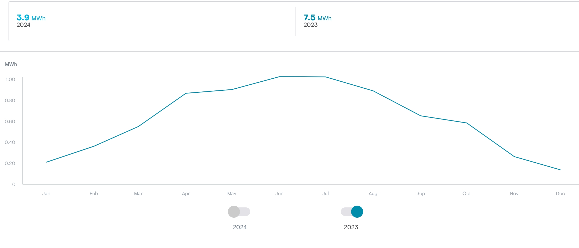

What does your 10kw system produce through out the year? What's January production? May? And maybe July to give me an idea
What latitude?
   / Solar production. Panel ratings/claim vs reality #14
What latitude?
Ours is a smaller system, with less than perfect orientation.
Dec/Jan is about 20% of June. If we were to pull the angle of the panels from about 20 degrees up to about 30-35 degrees, the winter production rises to about 40% of the summer production, though the summer production would take a 10% or so hit, per PVWatts. That's the plan for the next array.

Our array is 7500 watt (375X20) via Solaredge optimizers and inverter.
Production is just short of 9 mega-watt-hours per year, just under 25
kilowatt hours per day. Located near central Minnesota so it may be applicable to your location, (except for snow loads). Roof mounted, fixed south orientation.
Our utility uses two meters: one bi-directional for the service and another for PV production. Monthly bill shows both totals.
When installed, it produced enough to exceed our use in the summer and resulted in a credit on the bill and in the winter we had a bill due.
On average it was a "wash".
Since 2019 we have done some energy saving changes (but also some energy using ones: A PHEV for her, EV for me). This has resulted in having a bill most months although it is small compared to pre solar.
So install as much as you can is what I can say.
The Solaredge app says we are on track to be at 45 MWH when we hit the 5 year anniversary date.
