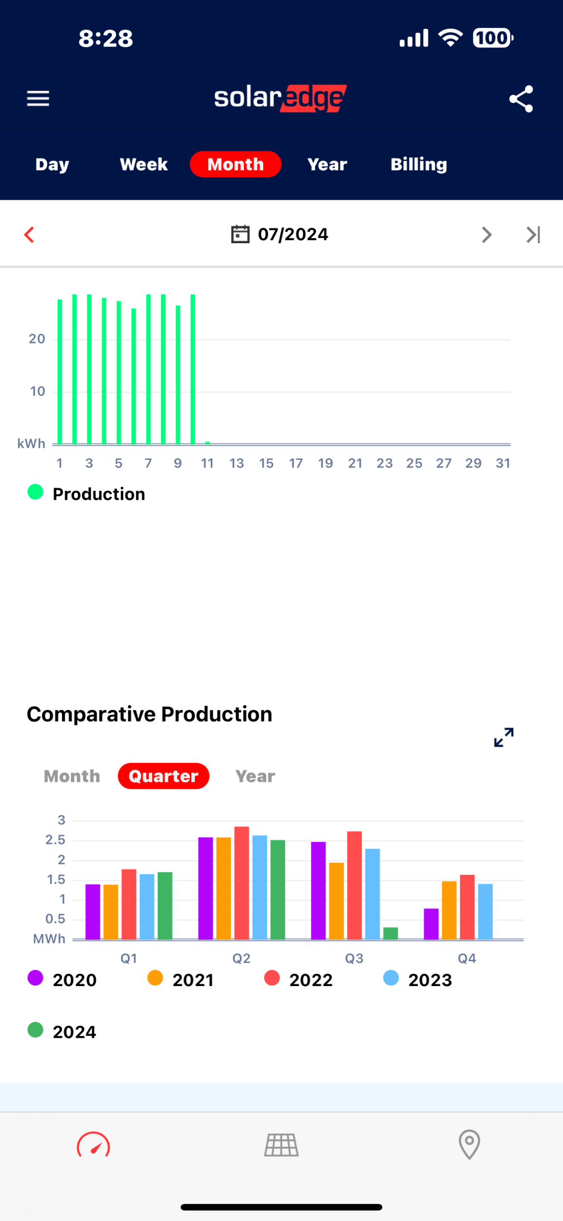

Hi LD,
December 2014 Installed 24 LG Mono Panels 300 W with Solar Edge inverters for 7,2KW
Garage Roof Mount – 38* angle, 190* south facing, Latitude 42*
Cost installed $26K, State credit $4000 Federal Credit $8500 net cost $13,500
ROI was 8.5 years – electric cost .18 KWH when we installed then rose to .22 then to .33 last year. We are grandfathered into true net metering where they pay us for excess at the same price we pay for electricity so if we over generate they send us a check that month.
Annual use – 10-11,000 KWH vs annual generation 8100-8600 KWH average
Q1 – 15-1800 KWH
Q2 2700 KWN
Q3 2600 KWH
Q4 15-1800 KWH
The lowest generation months are December, January and February mostly due to sun angle and snow, but they shed snow pretty fast.
I like your idea for doing the tilting ground mount, and really I think you need to keep it simple with one adjustment for summer and one for winter – makes it easier?
Also you should factor in some increase in electricity rates – they never go down, and then the cost for delivery (poles lines etc) is going up everywhere.
I have 3 arrays on tilting ground mounts and changing the the tilt is a minute per array… a single bolt to pull and move to the next slot.
15 years now with 160 W panels and a SunnyBoy inverter.
Each year I receive a small check around $300 at true up for my 6kW system although with new increased monthly charges approved who is to say?
