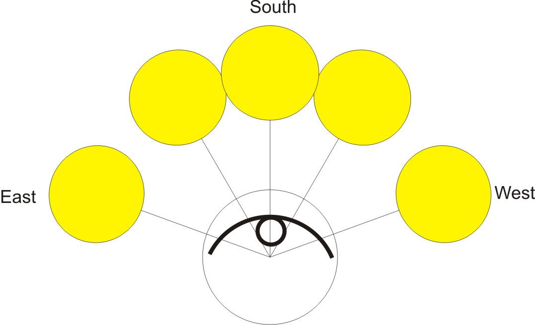

I've seen something similar. The advantage would be when the sun is east and west of the panels. I think it would have a more direct 90 deg. exposure longer producing more heat.
So if theses were spaced 1" apart I think it would work.
Phil

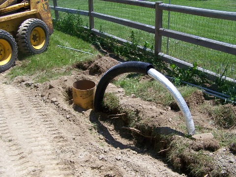

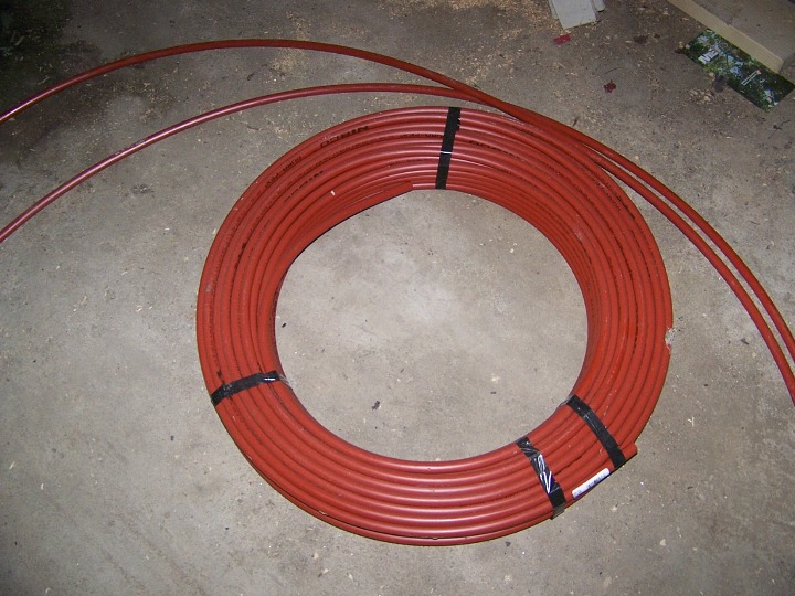

I used wood boiler pipe.
The first plan was to cut 2' thick foam and dado to lay in 2 1" type m copper pipes and then cap with 2' pink foam and back fill. I had a concern if ever a leak that I would have to dig it up.
The boiler pipe is 2 1" pex triple foil wrapped and in the corrugated non perfed pipe.
Phil

I bought an Uncle Henry Mag and called all the out door wood boiler places till I got the best price. I can't remember the name of the place but I believe it was in Readfield Me. Don't be afraid to shop around and ask questions. They will cut to length as well per foot cost.
I think I paid $7.00 for oxygenated.

I thought that I took some pictures but, i can't seem to find them. I went through the crawl space wall 8" cement block. I drill a bunch of holes with a hammer drill and cleaned it out with a hammer and chisel. I then cemented a piece of 3" schd 40 pvc pipe. The outer black pipe from the pex should fit over and the pex inside. I siliconed the daylight out of it and put a large hose clamp to hold it there and then buried it.
Inside I spray foamed it. I hope this helped.
Phil

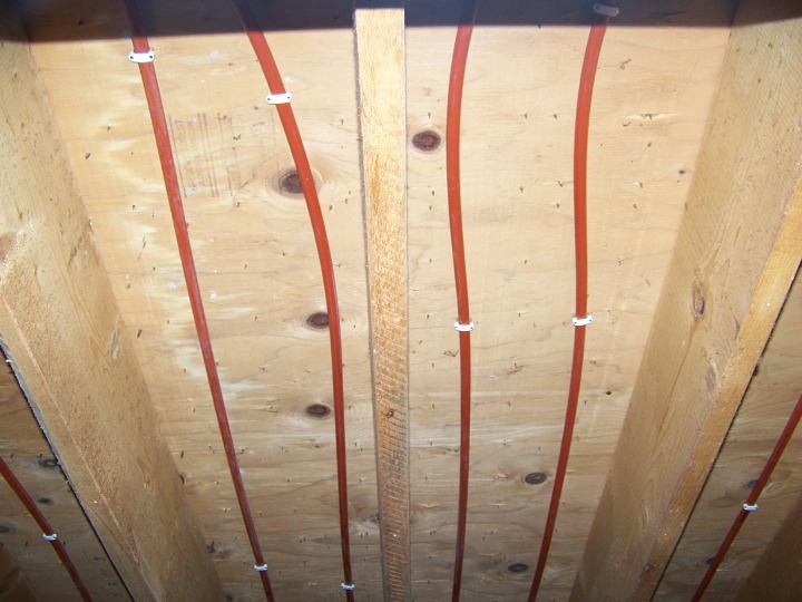

#107

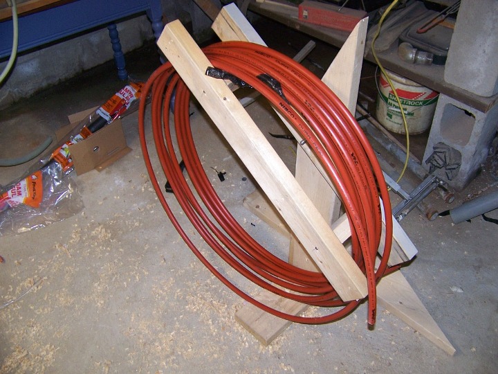

Time for an updated.
We started installing the radiant floor tube yesterday.
A few pictures.
The rolls were a pain in the you know what to deal with so I made this dispenser to do so.

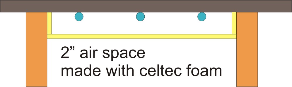

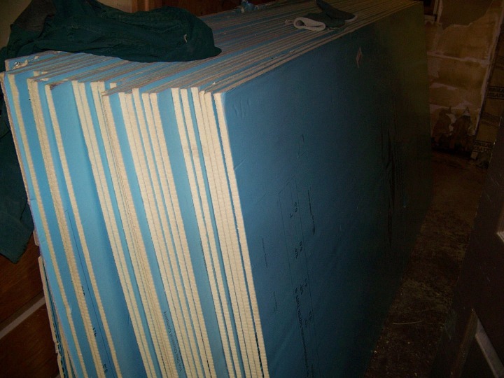

I plan on adding some 1/2" foil faced foam to create the 2" air chamber. I hope this foam does the trick.
So far we have put up 1200' I'm using electrical staples to hold the tubing up.
Phil

any particular reason for using plastic wire nails as opposed to something more conductive that would help transfer the heat from the tubing to the floor? like all metal conduit straps or something with more conductive surface area?
also curious about the 2" air space. is it that important or could you just attach the celotek foam board to the bottom of the joists saving some work and install time and basically making an 8 or 10" air space? seems like you would eventually heat up the enclosed space and the floor joists would become heat transfer elements as well, although i could see it would lower set point reponse time.
i'm also seeing some challenges in attaching the bottom celotek piece to the thin side pieces. you'll have to use long screws or something to get it to attach firmly to a wood component.
sorry if these were answered in previous posts.... thanks for sharing! ;-)

#110
Paddy,
My system was designed by Radiantec in Vermont. They have many years experiance with radiant heat so I trusted them as my resource.
There estamates are free and if you by from them they will provide the specs and how to!
The 3 panels currently bring the water temp in the 120gal.solar storage tank from 90 to 165 degrees. The floor only requires 110 degs. This will recurcular through a heat exchanger. Your pad may only need 90.
