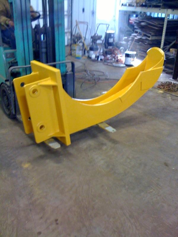

I built a narrow (6") ditch bucket for my 580B several years ago, have clay soil, spent as much time dumping as filling :=(
If I ever need that function again, I'll either rent a trencher or build one of these (don't remember where I got the pic, I do a LOT of "researching", spelled T-H-E-F-T :=)

You bucket looks like a cribbing bucket. We use them to crip out the ballast between crossties on the railroad. They do pretty good for digging narrow trenches too.
what no hand ties lol rail roader myself
