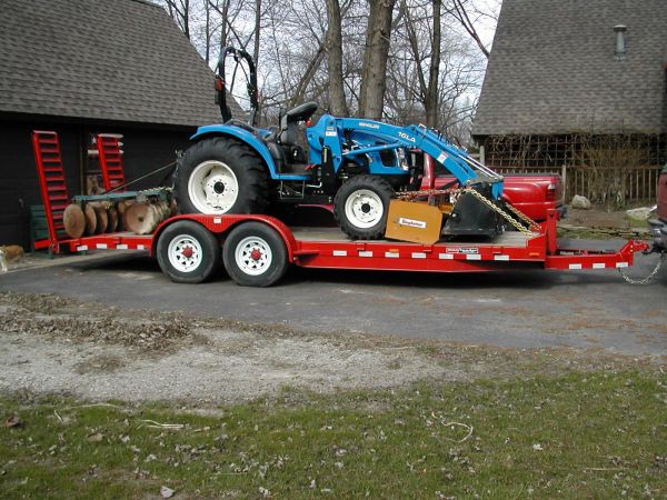

Anybody have any suggestions on the way I've got this tied down? I think I know what I'm doing, but maybe someone else has a better way. I don't need a trip like Dargo ya know. /forums/images/graemlins/grin.gif

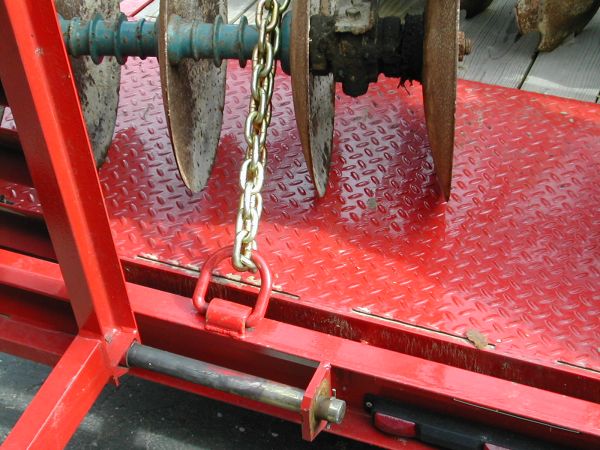

#2 I welded these Drings on the other day.

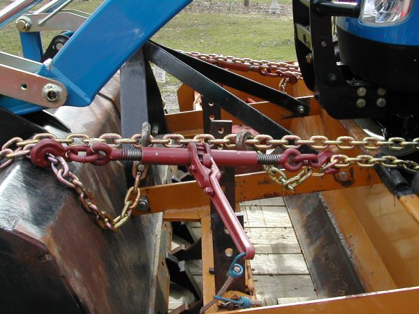

#3 My rear chains looped around the axle.

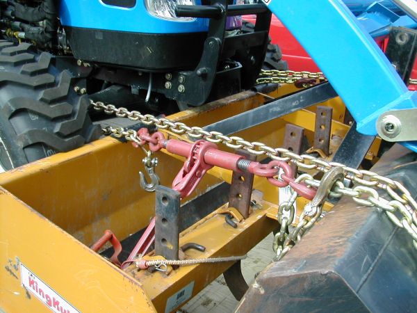

#4 Front chains with ratchet binder, looped around front axle and thru Drings on front of trailer.

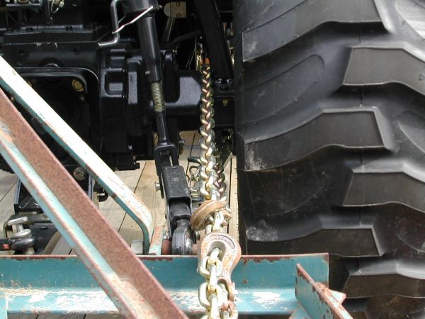

#5 Ready to go upnorth and kill some trees. Leaving tommorow afternoon. First real job for this TC. Thanks guys, fire away at me. /forums/images/graemlins/grin.gif /forums/images/graemlins/grin.gif

All you need to do, is tie down each corner of the tractor (axles) to the corners of the trailer. Id put the auger in the bucket and curl it down. I wouldnt tie down the boxblade since its wedged between the tractor and the bucket.
RSC around here just runs a chain through one side to the other going through the tractor. They just use two binders, one for the front and one for the backl.

I don't know that laws in your state but in NY we are required to bind opposite corners with a ratachet binder and at least 1/4" GR 70 chain.
PS: Like the right front corner of the tractor to the left front corner of the trailer.

In my mind the tractor should be tied town with four chains, and then the implements should be secured with additional chains.
It seems like from what I can see in your photos that you are doing double duty with your chains. They are both holding the tractor and the implements...
I would not be comfortable doing this myself...but it could just be because I don't know better.
I would probably use four chains for the tractor, each which would go directly to tie points on the trailer, and additional chains to hold the implements.
My worry would be as you have the tractor chained down, with the chains running over the implements, that this could give additional opportunity to slack to develop in the chains as time passed when you were on the road...
