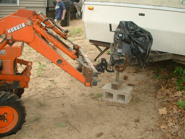

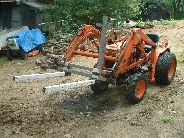

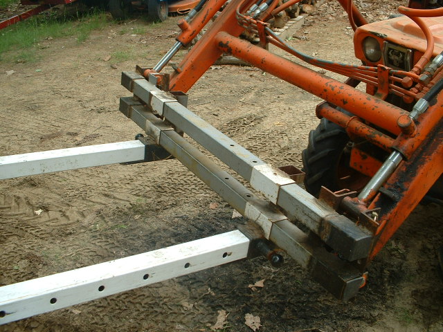

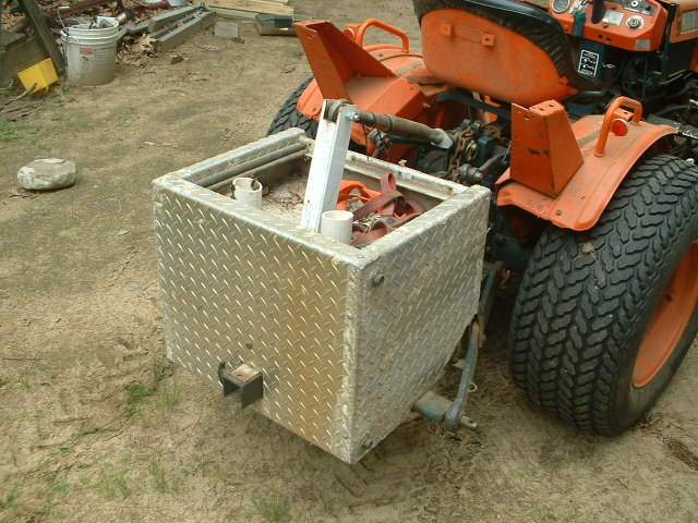

Here's a couple pictures of some add-ons I made this spring. The forks need a bit more work but they handle the limit of my little tractor. Most of the parts are from an old weight lifting bench, you can see the receiver for the forks will also accept a 2" hitch and they can slide side to side. The bench had quick release sprung pins which I used for ease of removing forks/draw bar. The way I built the frame allowed for vertical tubes for safety but I have yet to cut any which is why I stuck the "t" one just to show it. The other pic is of my weight box. This was a truck box that I cut down to fit my tractor and loaded with cement. Again I have one of the weight bench quick releases so I can add a hitch easily. The white tubes allow me to shove a rake or shovel plus there's space on top for straps etc. All in all I'm pleased with both setups. Having a set of forks is a huge plus.
