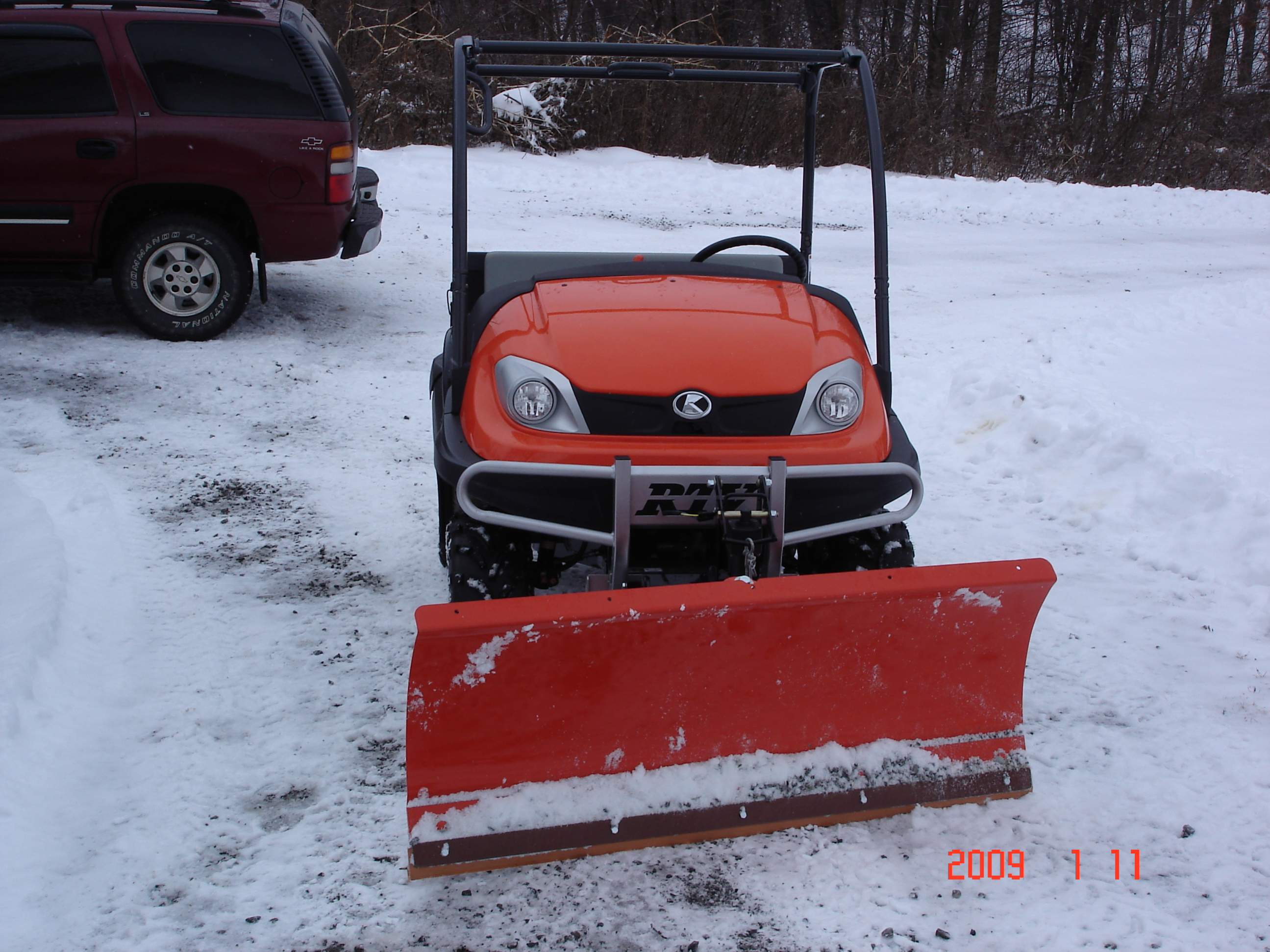

Well, we got 9 or so inches of snow this weekend. The 500 did far better than I expected. It never ran out of power. Did 9 driveways of 100+ feet in length.
Observation: The plow is too heavy for loose gravel, if you have a paved driveway, it's perfect.
I had to create a buffer between the cutting edge and the ground with a piece of urethane. I welded together 2 pieces of 1/8 inch plate and placed the urethane between that and the cutting edge with stainless bolts. Also, I ground off the 90 degree edges to prevent digging.
The skid shoes don't make it to the ground, let alone lift it. I told a Kubota service rep about thus, and he said they would weld extensions on to them. I told him he has to be kidding, this is a $1500 plow. So I was told to pound salt and wait for a corporate solution. Not good for something that cost's this kind of money.
Anyway, here's what I did:
