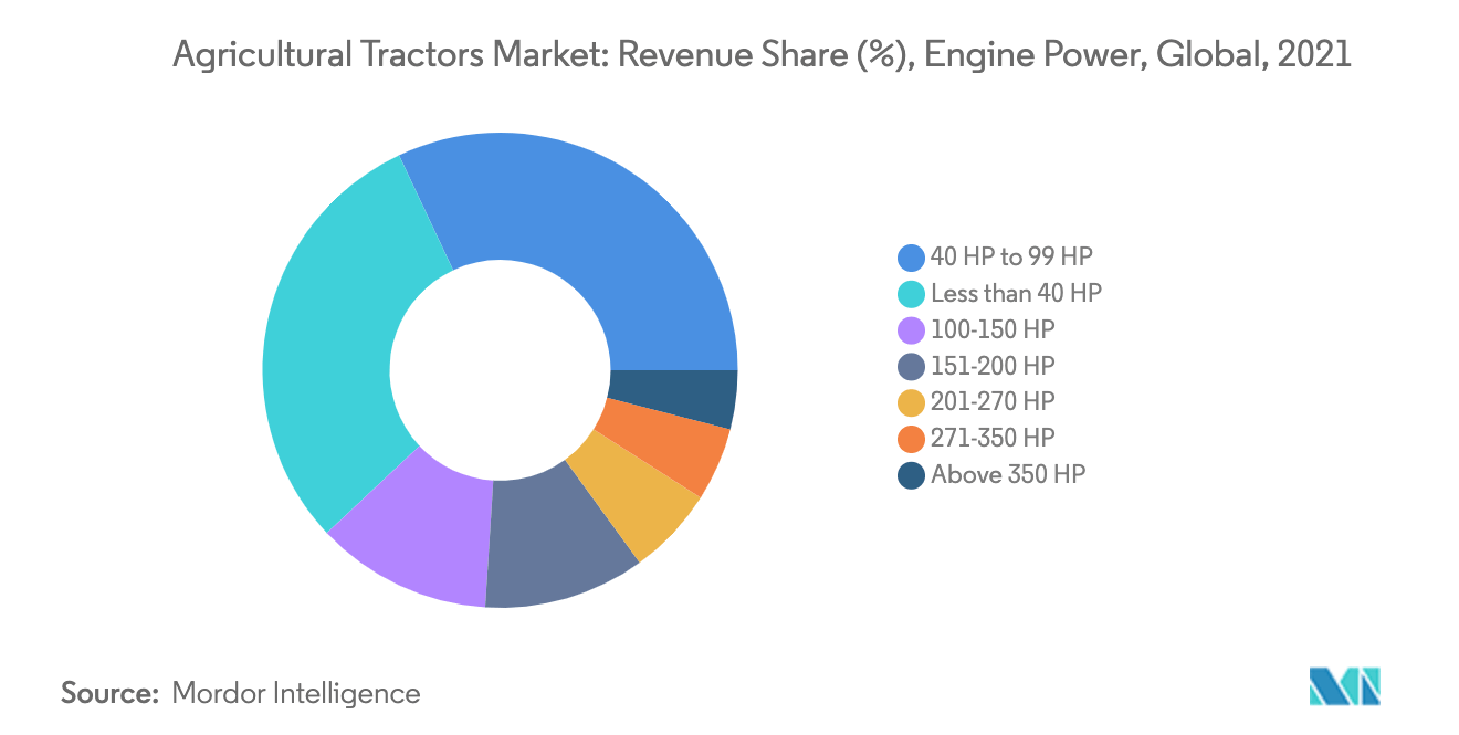

... (requiring ~100 HP) will require at least a megawatt-hour of battery,...
1/3 of tractors sold are less than 40 hp: Agricultural Tractors Market Analysis, Size, Share | Industry Growth (2022 - 27) (I paste the wrong URL before)
I would guess that most of these smaller tractors are run for only a coupe hours at a time and not at WOT. I know I may have days where I mow for 4 hours, but mostly I move a bale or two and park it. There is plenty of time to recharge even on a 15 A circuit.
It's not all or nothing. For possibly most of us, the benefits of reduced maintainance and increased reliability will outweight the shorter run time.
