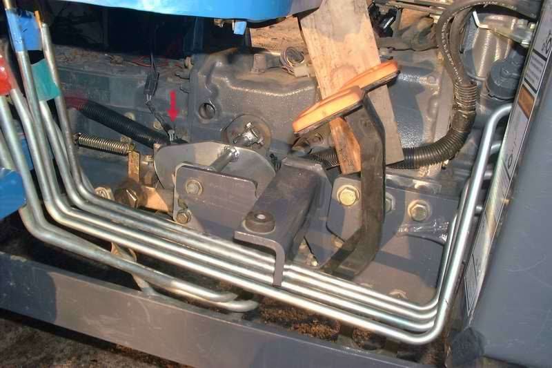

Well guys, it's going to the hospital. There was a part not shown on the drawings I dealt with. The only way to describe it is to say it had a bellcrank on one end that had lost it's nut. The bellcrank is on the end of some sort of dampener [I think thats what it is] that I could compress and extend with no trouble, it also has a dust boot attached. I can't determine what it is much less a name for it. /forums/images/graemlins/confused.gif I hate it when I don't know the name of things. At any rate, there sure isn't much room under there! That was another surprise. After I made my fix, I checked it out. Now the pedal won't stay down as much as before. After all the advice from you guys, I'm believing it's the magnet too. Think I'll let a little more knowledgable hands get on it. I'll let you guys know what was found so if it happens to you, you'll know what to do.
Hey Chris, if I gave a good enough description of the mystery part, could you figure out what and why it's there? Like I said, it really irks me not knowing what parts are what on anything mechanical, especially when they are my parts. /forums/images/graemlins/smirk.gif
   / Sometime cruise control? #25
Jinman may be the better person to answer this - he has had his entire deck off to replace his HST control linkage (pivot plate). This part is highlighted in the attachment.
A picture, maybe?

Chris; Wow, you guys are really trying to help! /forums/images/graemlins/smile.gif The damper is part #11 on the exploded view. What I'm calling a bellcrank is toward the backend of it and bolts up thru part #23.

A picture might help you see what I'm saying, but my little Nikon 775 won't focus down that close.
   / Sometime cruise control? #30
Chris and John, I go away to clean my garage and it seems you've about figured this out. /forums/images/graemlins/smile.gif
I'll post a couple of pictures, but I have to run pretty quick again. I'm sure you guys can figure this out just fine without me. /forums/images/graemlins/wink.gif
The first picture is the assembly with the big "B"-shaped plate removed. You can see the damper and also the bellcrank that has the roller that rolls on the B-plate. In the upper left you can see the cruise electromagnet.
