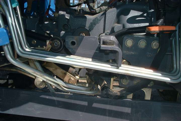

Oops! /forums/images/graemlins/blush.gif I got my pictures backwards.
Here's the one with the plate out. In the last post, the red arrow points at the electromagnet.
   / Sometime cruise control?
#32
Guys; I'm getting the picture now! /forums/images/graemlins/smirk.gif Pun intended. Looks like the damper is used to dampen the return on the forward and reverse pedals and had nothing to do with the cruise control after all. Well, triple hmmm. It must have been disconnected when it was delivered. I never noticed any difference in the pedals though after I'd reattached it. /forums/images/graemlins/confused.gif I think I'll give up for now and let the dealer check it out further, wonder else might be found? Think they'll charge me for pickup and redelivery? /forums/images/graemlins/confused.gif

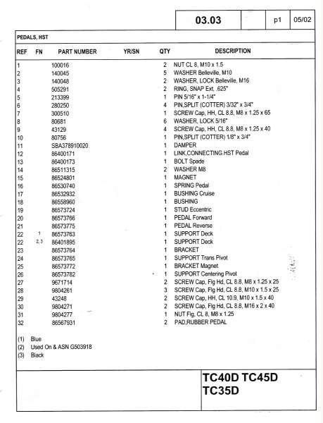

I've attached the actual parts list for the previously attached exploded diagram. If you use the actual terms the parts/service guy should give you a little more R-E-S-P-E-C-T. /forums/images/graemlins/grin.gif

Chris; Thanks for the drawings with the proper names. I felt a little better being able to explain the problem intelligently to the mechanics. /forums/images/graemlins/smirk.gifThey've got my machine, but don't know whats wrong. /forums/images/graemlins/confused.gifThey're telling me that they have 3 TC's on the line. One of them the cruise works as it should, one a "little like mine", and the third just like mine. Needless to say my confidence has diminished somewhat. /forums/images/graemlins/frown.gif If the mechanic wasn't a friend of mine, I'd have zero confidence right now. We discussed the problem and came up with that it appeared the magnet wasn't holding properly. No surprise there. /forums/images/graemlins/smirk.gif I'm wondering after looking at the schematics in the owners manual if the diode might be bad,or even the latch relay.
