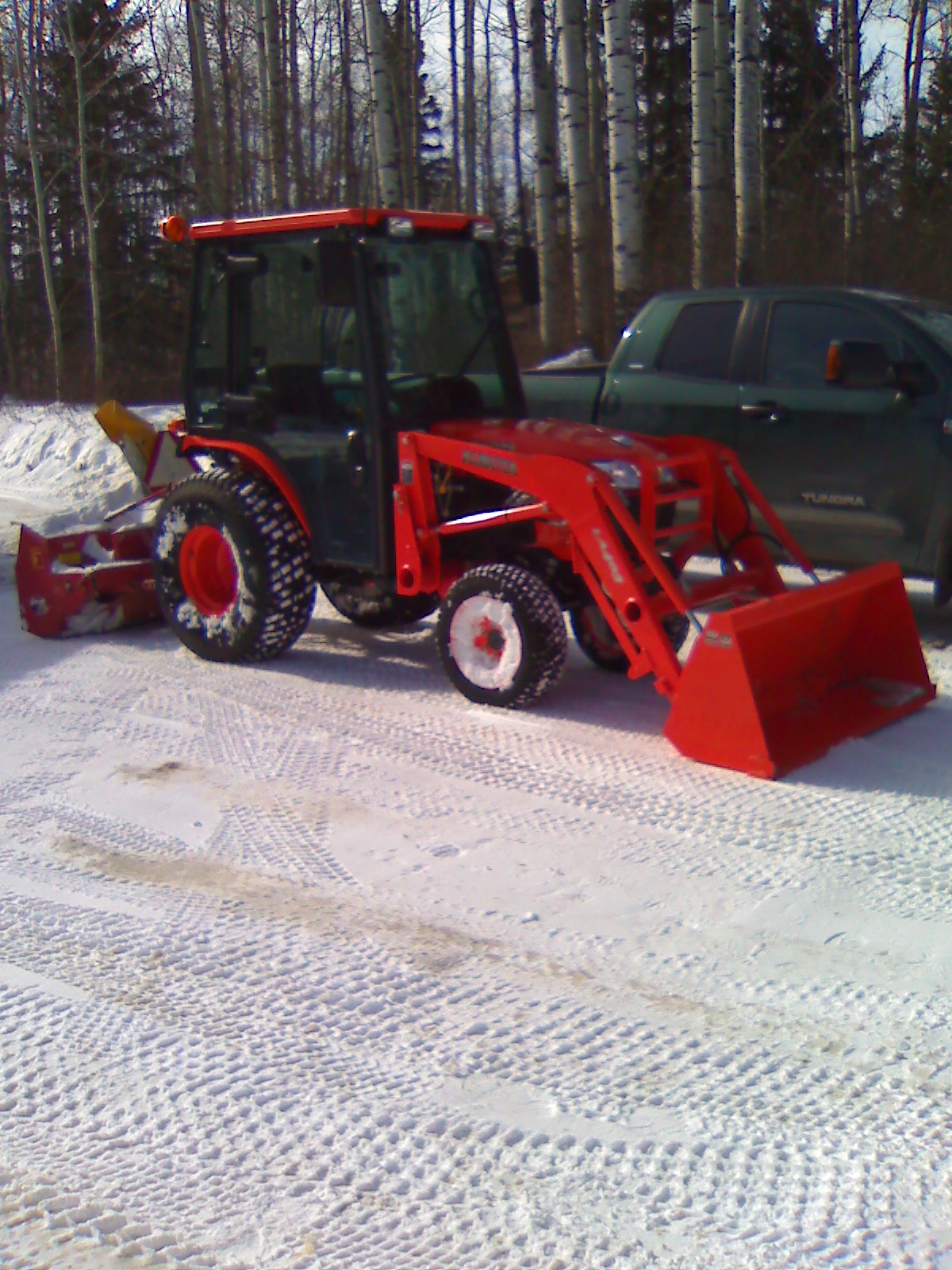

Very nice work done by all!!! My tractor is not cabbed yet but very annoyed also with the soot, I think since it's not cabbed the best solution would be a straight stack right ??? I am hopping to start building the cab this summer.....right now I am alsmost finished building a reversible snow scraper/plow....

You might want to find another way of deflecting the exhaust on your tractor IF you don't have the cab yet you will smell the fumes sitting in the seat if you point in towards the back. My buddy got a Bx model and he has some lung problems. He uses his snow blower and with no cab running the exhaust back wasn't an option so I went up with it. I just extended the pipe and with some added bracing it worked out perfect for him. Yes it do look like a muffler but I just added an outside part to make it look more appealing. :D

Looks good 4Shorts, thanks for the pic!!! Maybe I will just wait till I build the cab then do something permanent!!!

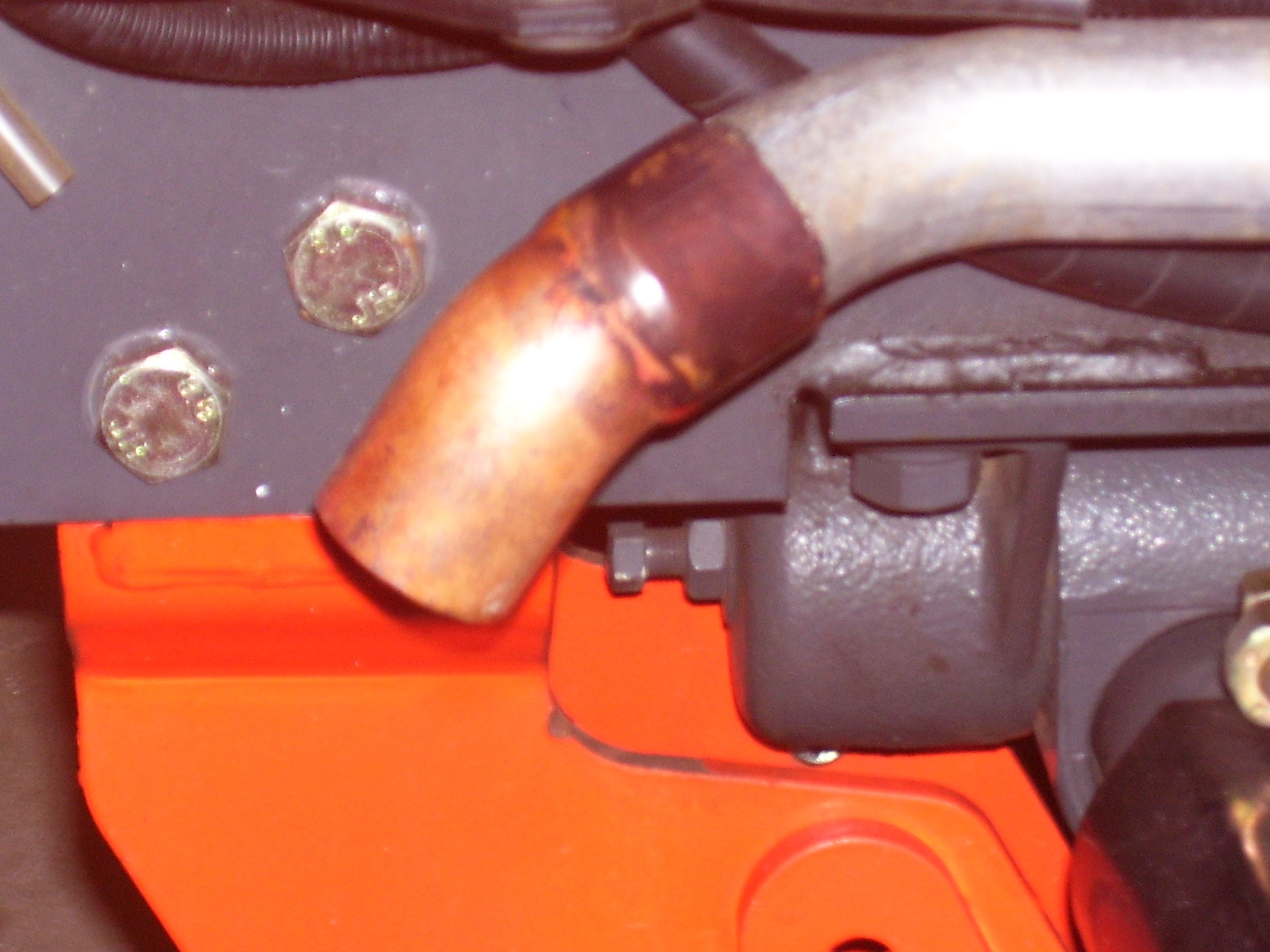

I'm in the planning stages of changing my 4610 from horizontal to vertical without buying a new manifold.

That was the same way I was going to change my exhaust and had all the parts picked up to do the mod but figured that I didn't need to complicate things going that way so I tried the easiest most efficient thing first and it worked.
No it won't stir up dust because the exhaust don't point straight down. It turns towards the rear just a bit. I did try it on a gravel road and it worked great. Thanks. Glad you liked the tractor :)
(see attached picture)

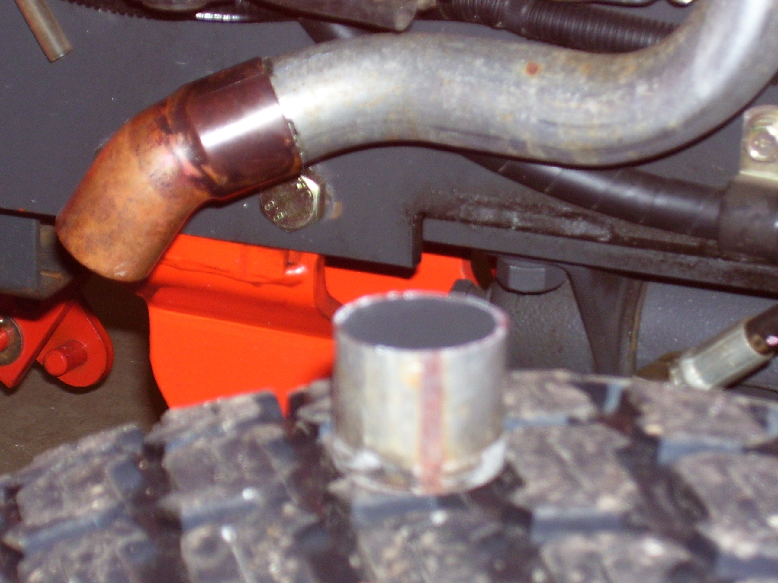

4shorts,
Dream bend on that pipe (in my dreams) and the Hyd. bender too .. .
Might want to protect the assembly from ice chunks when backing down from a pile - wouldn't want to tweek something so pretty - see the silicone rubber tubing in the pic - could be added anywhere above the outlet . . .
Dave
PS: EDIT - just noticed the brace - should have known better you'd have all the bases covered . . .
Good advise Dave. Love the way you did yours. As always you've done a great job. I've plowed all this winter with the set up I have and it's worked so It's a keeper for now unless I decide this summer to adapt two chrome stacks on the little beast :D

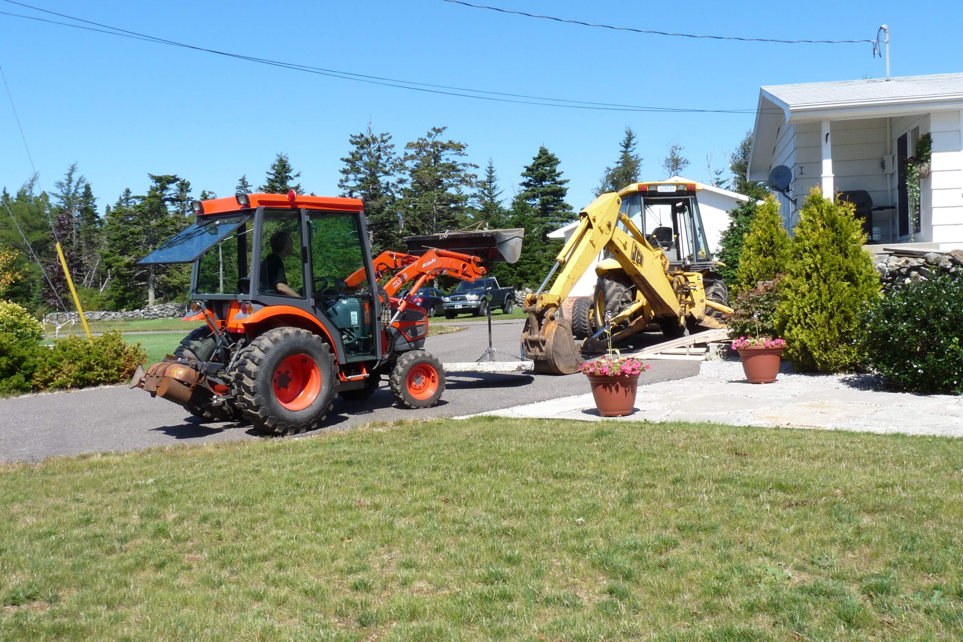

Another option if people are worried about catching the pipe on something and bending it is.... flex pipe. I just did this on my new 3720 JD as it was blackening the side of the hood, front snowblower, and would have got the loader too, if I hook it on a stick or something it will give instead of bending or harming the stock exhaust pipe.

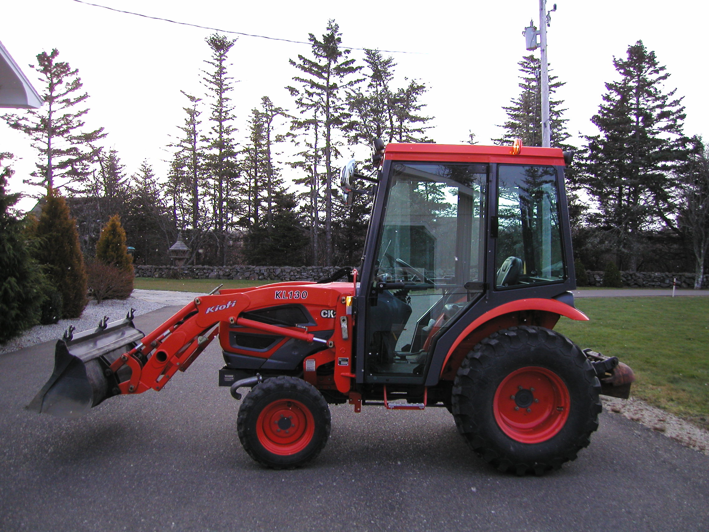

I took my L5740 to a local shop that had a tube bender. In about an hour they made this piece up for me. Ever since I got this tractor, I have been aggrevated with the soot on the FEL. I think I finally got it fixed. Hopefully the pictures work.

Aren't you going to have soot on your step now? What about smoke in your face since its so close to the operator's station?

No smoke in my face, as it blows down and out. It is just below the step also, so no soot there.
I could have taken it straight back out the back, but I like to see it smoke when it works, so all I have to do is look down now.
I have a lot of bush hogging to do in the next couple weeks so I can share an update then. As cheep as it was, if I have to redo it it won't be too bad. Why Kubota did it like they did is simply beyond me. That must have been a Monday morning design.
