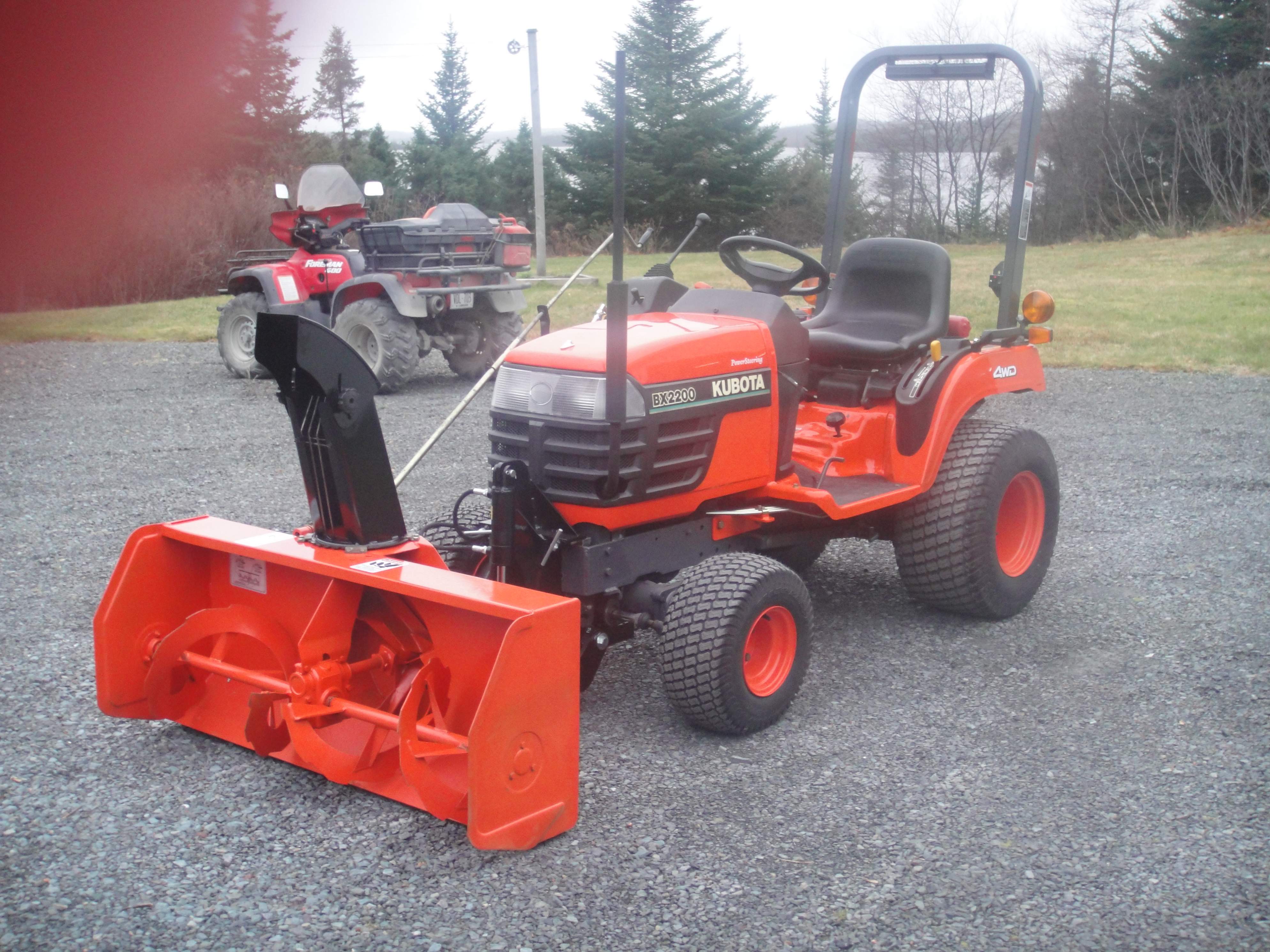

You might want to find another way of deflecting the exhaust on your tractor IF you don't have the cab yet you will smell the fumes sitting in the seat if you point in towards the back. My buddy got a Bx model and he has some lung problems. He uses his snow blower and with no cab running the exhaust back wasn't an option so I went up with it. I just extended the pipe and with some added bracing it worked out perfect for him. Yes it do look like a muffler but I just added an outside part to make it look more appealing. :D

That's a nice looking tractor you have 4shorts.
With the exhaust pointed down, do you think in the summer it will stir up a lot of dust when you drive?

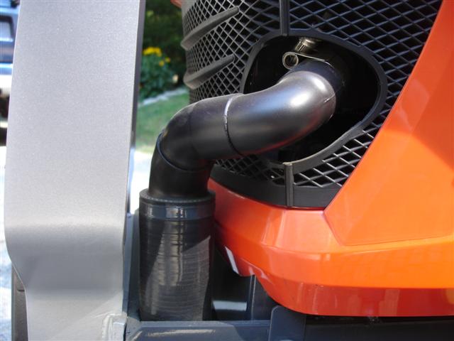

Dream bend on that pipe (in my dreams) and the Hyd. bender too .. .
Might want to protect the assembly from ice chunks when backing down from a pile - wouldn't want to tweek something so pretty - see the silicone rubber tubing in the pic - could be added anywhere above the outlet . . .
Dave
PS: EDIT - just noticed the brace - should have known better you'd have all the bases covered . . .
I'm in the planning stages of changing my 4610 from horizontal to vertical without buying a new manifold.
That was the same way I was going to change my exhaust and had all the parts picked up to do the mod but figured that I didn't need to complicate things going that way so I tried the easiest most efficient thing first and it worked.
No it won't stir up dust because the exhaust don't point straight down. It turns towards the rear just a bit. I did try it on a gravel road and it worked great. Thanks. Glad you liked the tractor :)
(see attached picture)
4shorts,
Dave
Good advise Dave. Love the way you did yours. As always you've done a great job. I've plowed all this winter with the set up I have and it's worked so It's a keeper for now unless I decide this summer to adapt two chrome stacks on the little beast :D

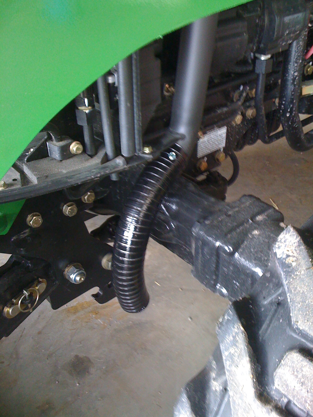

Another option if people are worried about catching the pipe on something and bending it is.... flex pipe. I just did this on my new 3720 JD as it was blackening the side of the hood, front snowblower, and would have got the loader too, if I hook it on a stick or something it will give instead of bending or harming the stock exhaust pipe.
