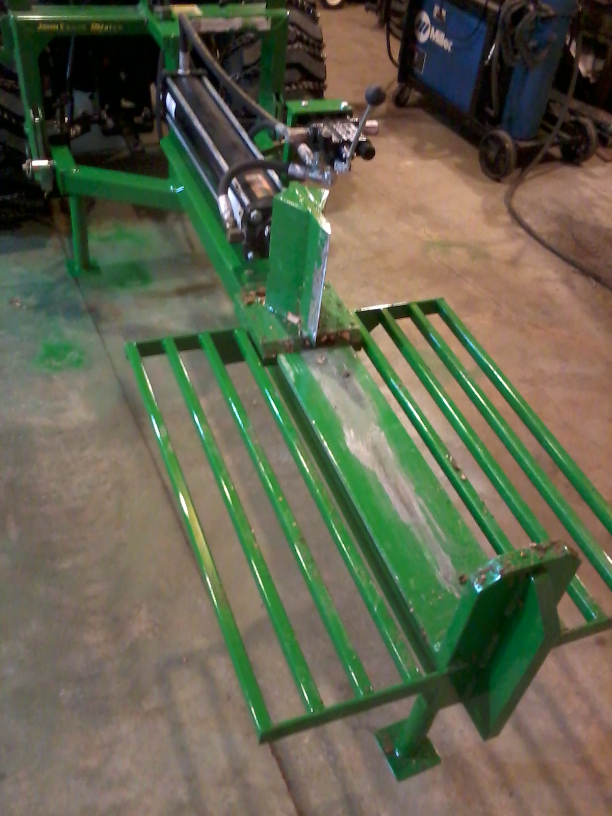

the kit has hoses and fittings to tap into the two ports on the bottom side of the loader valve. A bracket that bolts to the rops crossmember and a jumper hose to complete the circuit when not in use. I believe there was also a pipe plug I had to insert between the valve ports to close the internal valve loop. Took me an hour or two to install on my 2720.
I built my own 3pt splitter and used a valve I don't remember the no. but JJ has given the no. in other posts. but on the foreward stroke it has two positions and travels very fast in position one because it is pushing fluid to both sides of the cylinder. I have a 4 in. cyl. and the return is pretty slow but it's fast enough for me. I think about 15 sec. for a 24" stroke.
