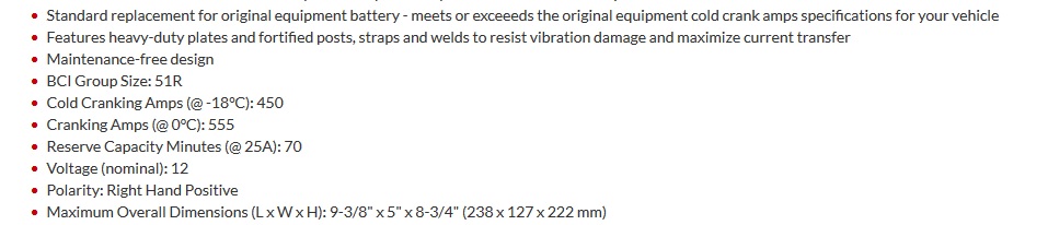

So going back to basics, what is the max recommended CCA for the GC tractors especially in winters of Maine? I know the higher you go the less the charging system can keep up and you end up with a charge deficit. That in turn wreaks havoc on the alternator and battery.
Batteries of the same size may differ in construction for higher CCA. The thinner plates are less resistant to vibration, and potential damage. Basic 51R with 450CCA works ok. Just changed mine out after 8 years (OEM lasted 7). Never had a tender, or charger hooked up to it.
