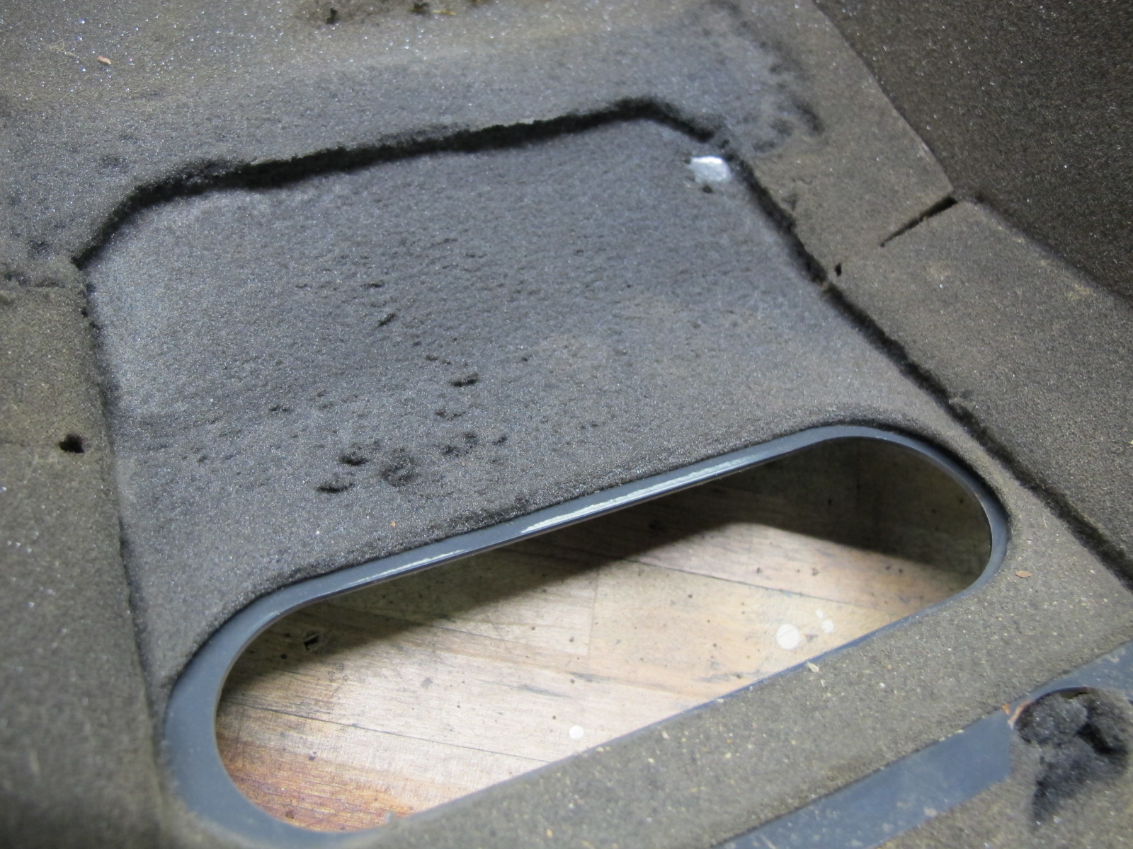

Bandit , did you put that foam in this picture at the cracks at the bottom? Near the floor mat?
If that is factory foam in those cracks then that is the reason my 2005 B3030 is full of dust and yours is not.
I have NO foam in these areas, just the formed piece of foam behind the plastic panel.
All of that is from the factory. I have not added anything yet, so yes, that is probably why I have much less dust than B3030 owners. Also, all of the levers, foot controls, etc. have either rubber or foam "gaskets" where they enter into the cab. However, I can still see bits of light making its way into the cab, so those areas will be addressed.
Let me know if that steel "toe plate" under your plastic panel has foam glued to the back side flat surfaces, as mine does. Either way, I can tell that foam is not dense enough to mute sound & vibrations, so more needs to be done with that.

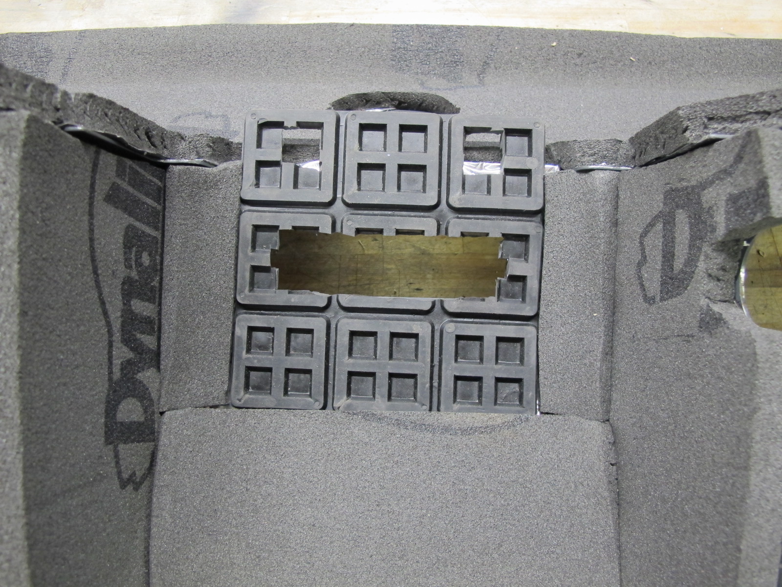

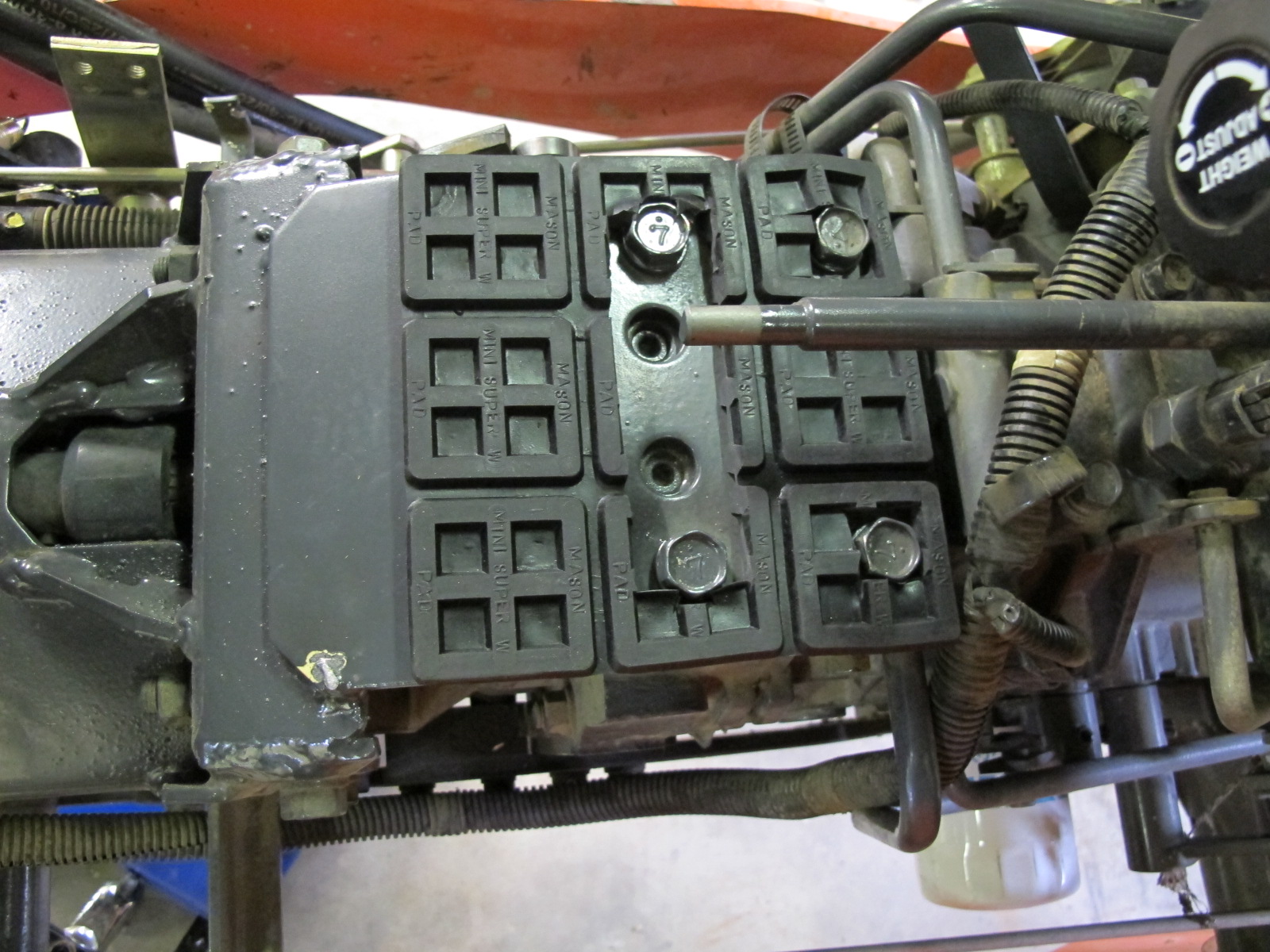

I really think, at least on my older B3030 this waffle pad is best and easiest to install. Kubota may have addressed this since 2005. Will it work? don't know yet.
I would be very interested to see Bandit's floor when he takes this panel off. Will it look like my first picture?
But you can see what the floor rested on before in the first picture(Nothing) The New rubber waffle pad is 3/8 thick the foam around it is 1/2 thick. Using any of these other type mounts will bring the floor up too high, there is no room for anything between the floor and that plate on the transmission. You would have to modify the floor and have the mounts stick up though the floor.
This mount was easy to install, dosen't change the hight that much and should keep in place because of the weight, shape of the floor, foam and bolt heads. There is no place for it to go. If nothing else it will prevent the metal to metal contact like it was before.
Now I know what that noise was when traveling along a rough patch as the cab rocked back and fourth that grinding sound on and off, I thought it was the transmission but now I know it was the grinding of the metal cab floor touching the transmission plate in those three worn to metal spots.

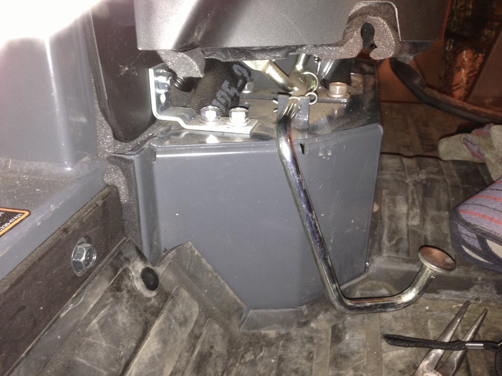

I noticed today while moving the tractor that I had a vibration noise coming from the small hump directly behind the panel under the steering wheel. It is the area where the gloves are located in the picture. Anyway I put my left foot on the hump and put pressure there and the noise disappeared. So I'm guessing I too need to put some rubber pad underneath to cut down on the noise.

I finished everything but the front panels behind the brake pedal and the same on the other side Tractor has a deeper quieter tone and the transmission whine now sounds like it's in another room and muffled. Really happy with the lack of transmission noise now.
Still noise from the engine but I didn't do anything under the dash yet or those front panels that are slanted.
At 2,000 rpm I can feel air from the engine fan blowing thru where Bandit has that factory foam, That will be next , That is where the dust is entering from and I'm sure it will cut down on the engine noise also.
So that rubber waffle pad works :thumbsup: and it is worth doing.
Just a note : The 1 inch thick hockey puck that others have suggested will bring the floor up too high and none of the floor mounting bolts will then line up. 3/8 is the maximum size the rubber can be used without doing major floor remounting. If 1 inch is used you would have to adjust the mounting holes by 5/8 of an inch.
This is why I'm retuning the 3/4 thick waffle pad. If I used that I would have had to oblonged the bolt holes by 3/8 inch.
By using the 3/8 waffle pad No mounting holes had to be modified. I also left the 1/16 dynamat on top and below the rubber pad.
I do appreciate their suggestions though.
