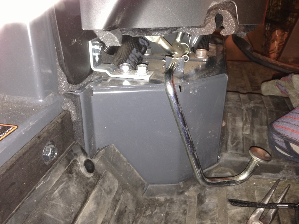

WaxMan,
I was digging around late this afternoon, and found an area that I think will be difficult to deal with, but am pretty sure needs more than the low density foam installed at the factory. I think it may be a big job to get to this section, as it appears to run both inside the cab and outside toward the engine compartment, but will have a better idea once I have things torn down. Have you thought about how to deal with this piece under the steering cover? It doesn't look like it'll be too easy to reach from underneath, and looks like it may not be able to be removed with the cab on the machine.

Bandit , did you put that foam in this picture at the cracks at the bottom? Near the floor mat?
If that is factory foam in those cracks then that is the reason my 2005 B3030 is full of dust and yours is not.
I have NO foam in these areas, just the formed piece of foam behind the plastic panel. From what I remember.
