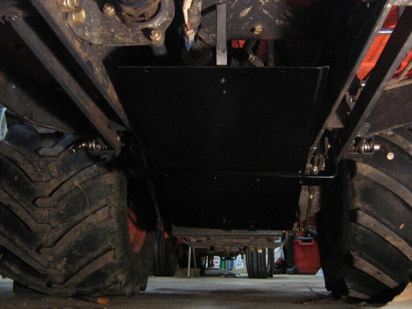

n3qik, I like that guard.
My el-cheapo skid plate.
That's nice VF. BTW, guess all you Vol fans were pretty proud of your alumnus #18 this past Feb. He's amazing, got the right attitude and work ethic. His papa taught him well.
