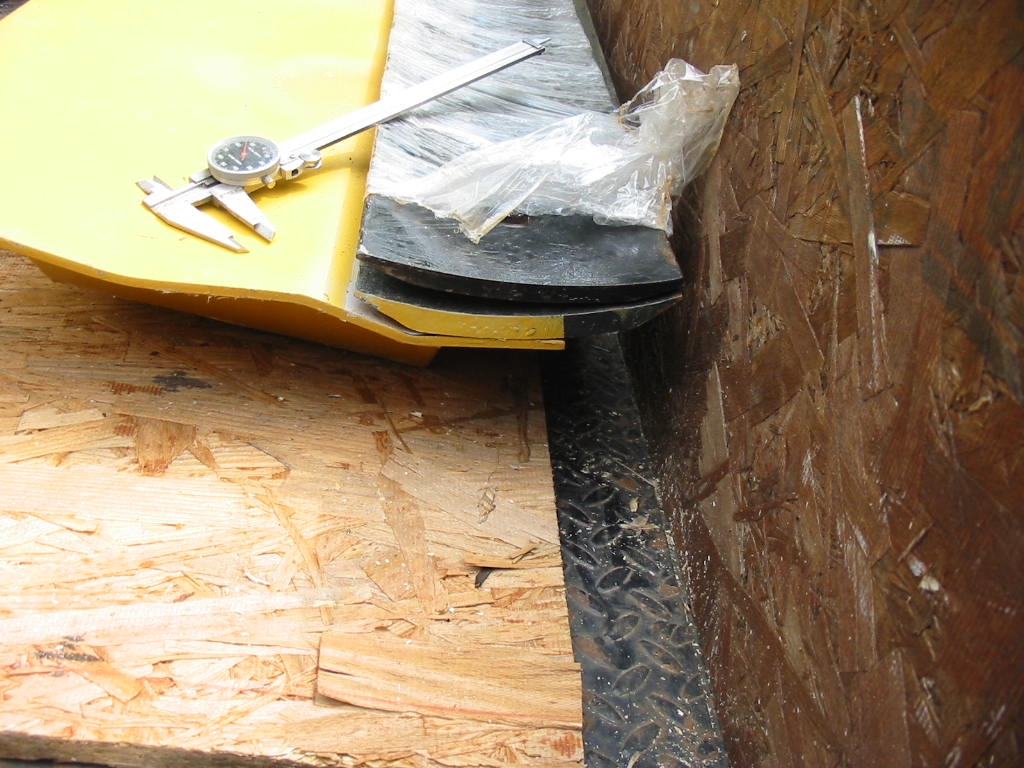

I am planning on fabricating a 72" Land Plane and need the 2 wear bars/blades. King cutter has them for $139 ea but they want $132 to ship them ea,buy two and the shipping is $264 and so on!
They have some available through Digger supply for about $450 a set. Again AgriSupply has them for $139 but shipping for 2 is $167. You guys in the south east could pick them up at the store I guess.
I'm in Wisconsin so if anybody knows of a source near me where I could pick them up please let me know.
There is a place called Behlin Country that has them. $99 plus $29 shipping. The only thing is they are only 3/8" at the thickest point. All of the 6' Behlin Country 3 point attachments use this so it must work.Who knows how it holds up to hitting rocks and such.I would be using the Land plane for gravel drives so hopefully most large rocks will have already been dealt with.
It looks like the 1/2" version weighs 58lbs and the 3/8" version is 39lbs. so it can be shipped by UPS as opposed to needing a trucking company. I ordered 1 to see what it looks like and I will use it maybe for the rear blade or just pushing snow. I noticed when you order 2 the shipping goes up to $160! So you have to buy them 1 at a time or the shipping kills you.
I have attached a picture to show how they look side by side. Again any help thanks in advance!

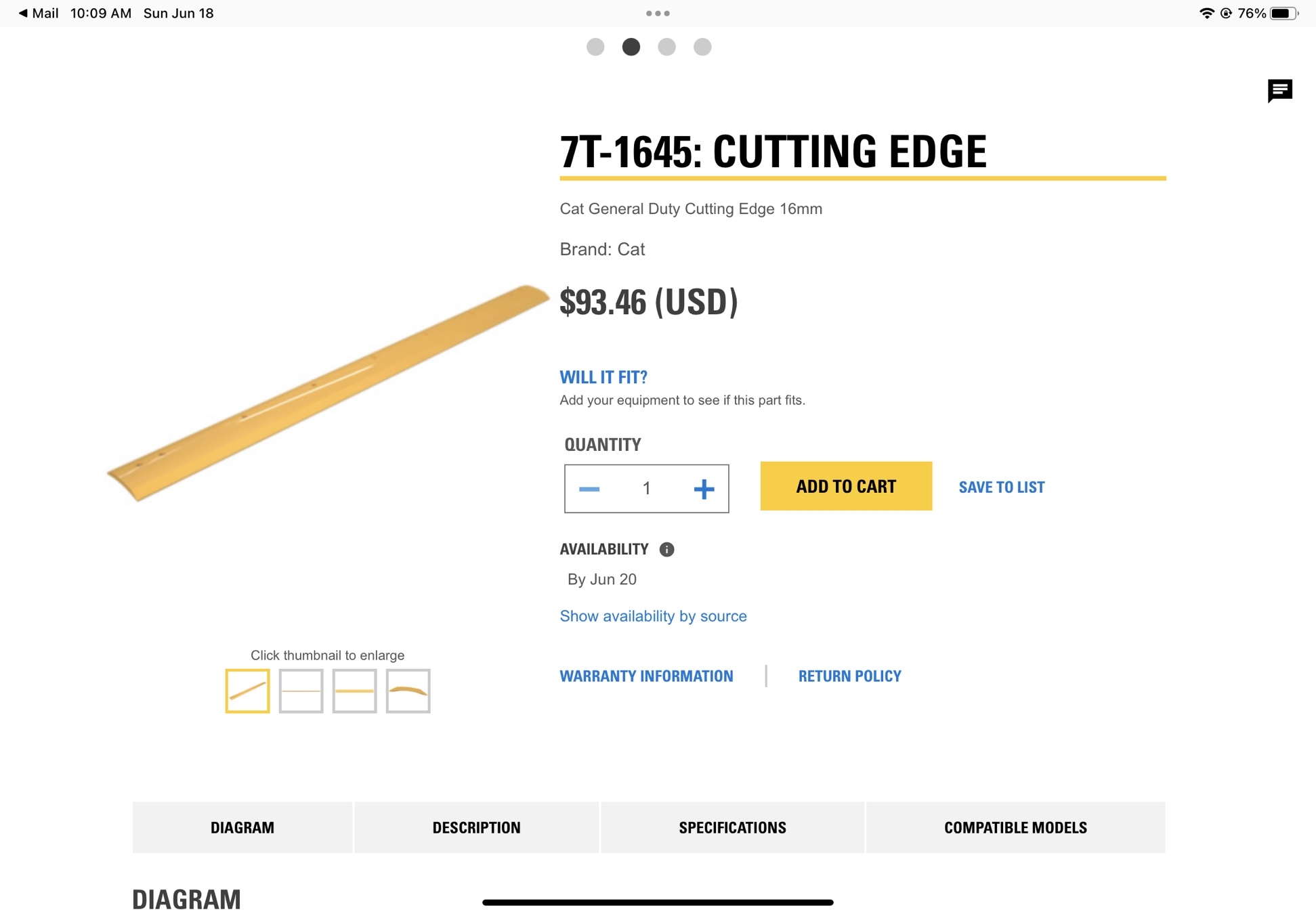

I am in the process of building one myself and found a good deal at the local CAT dealer. The good thing was they will ship it free of charge to your nearest CAT dealer. I bought 7 footers for $75 each about 2 years ago. The current price is shown below. Good luck!
