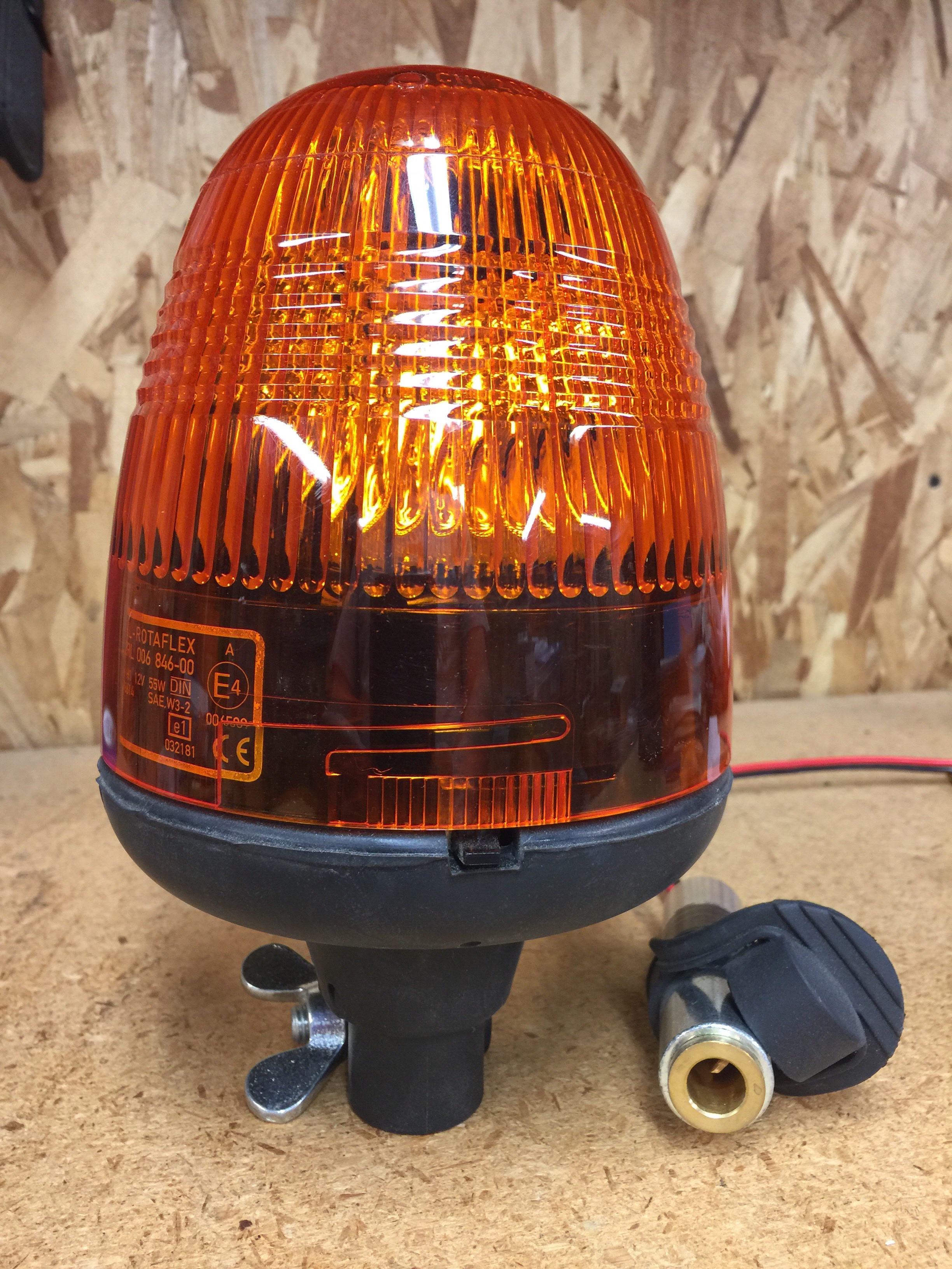

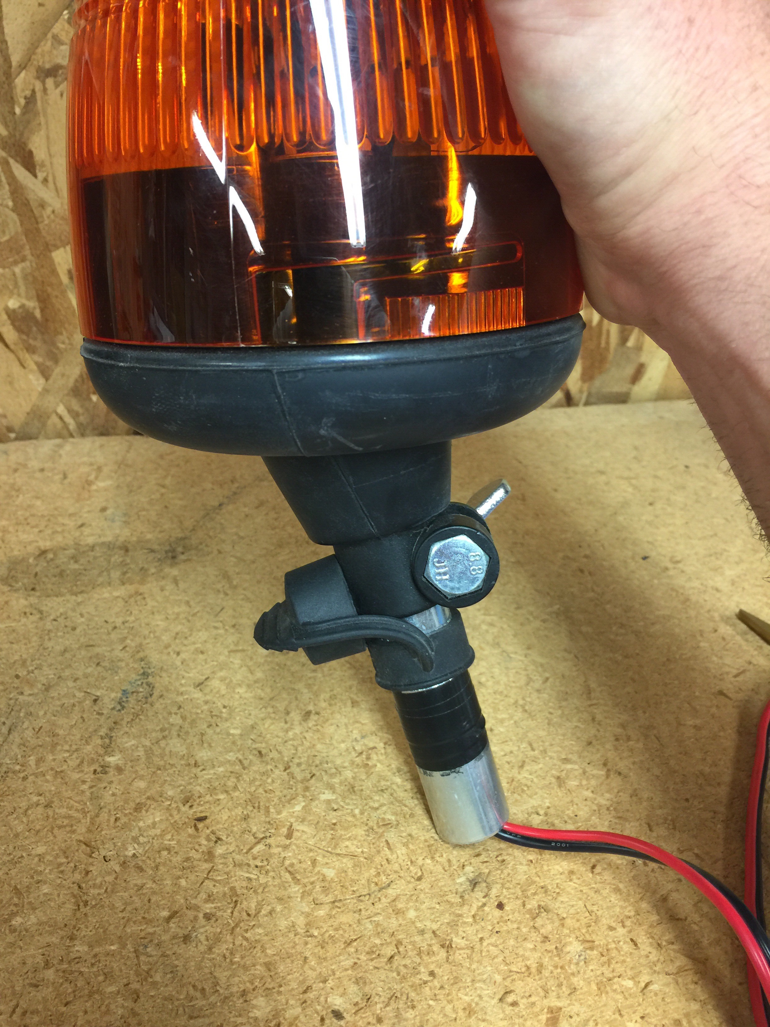

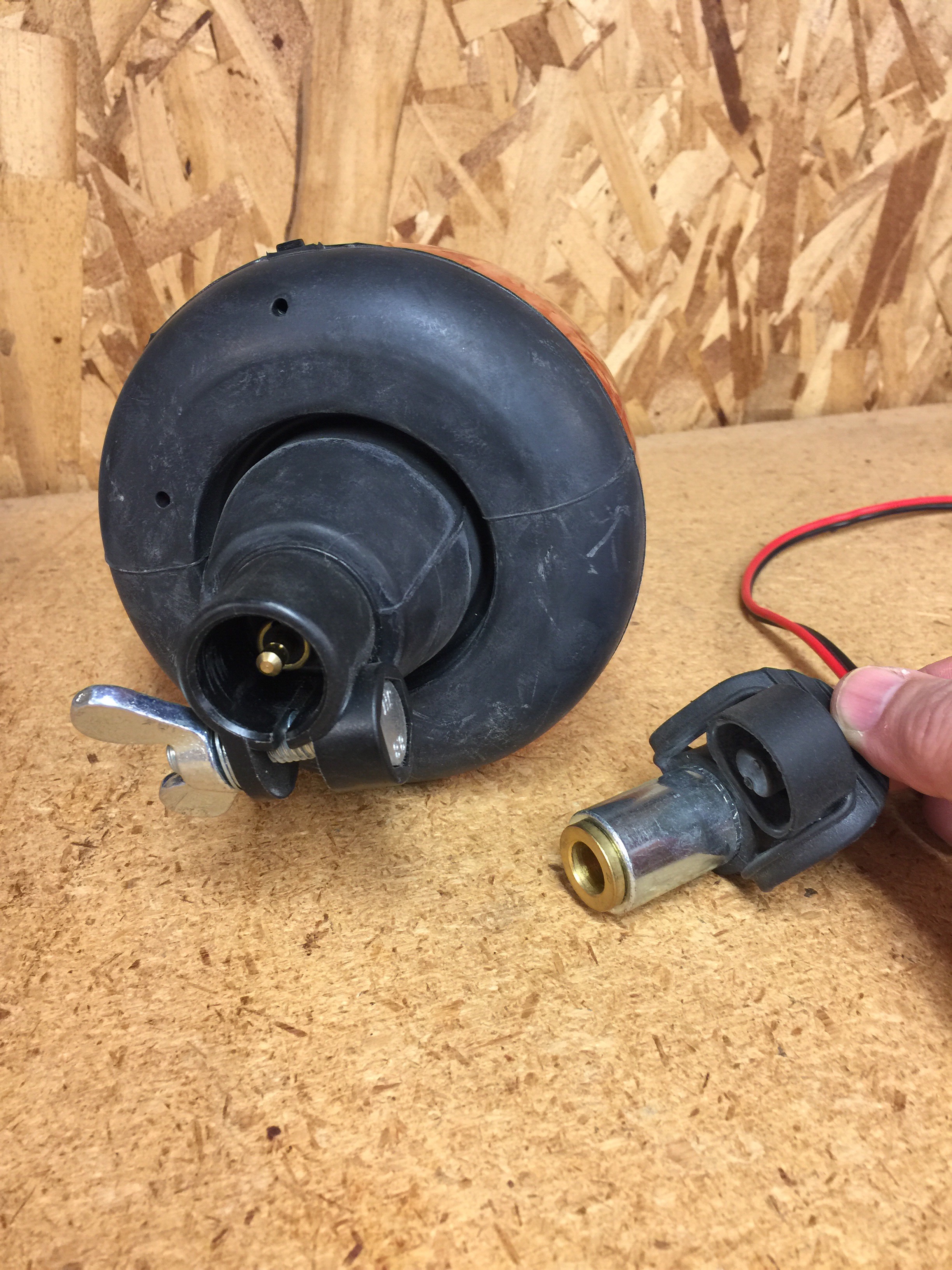

I highly recommend the Hella halogen beacon. I bought this and haven’t installed it yet but this has a removable light that can be taken off without tools when working in the woods and installed when plowing in the winter. There’s various mounting options and the one shown is just of of many. It has a dust boot.
What I like about this light is it’s absolutely made for rugged environments. The lighthead actually flexes, the bulb can easily be replaced with an H1 55w lamp.
I’ve been an emergency vehicle upfitter since 92’ and nothing beats the simplicity of a crisp flash of a halogen rotator, especially for high vibration equipment because it’s rubber insulated.
