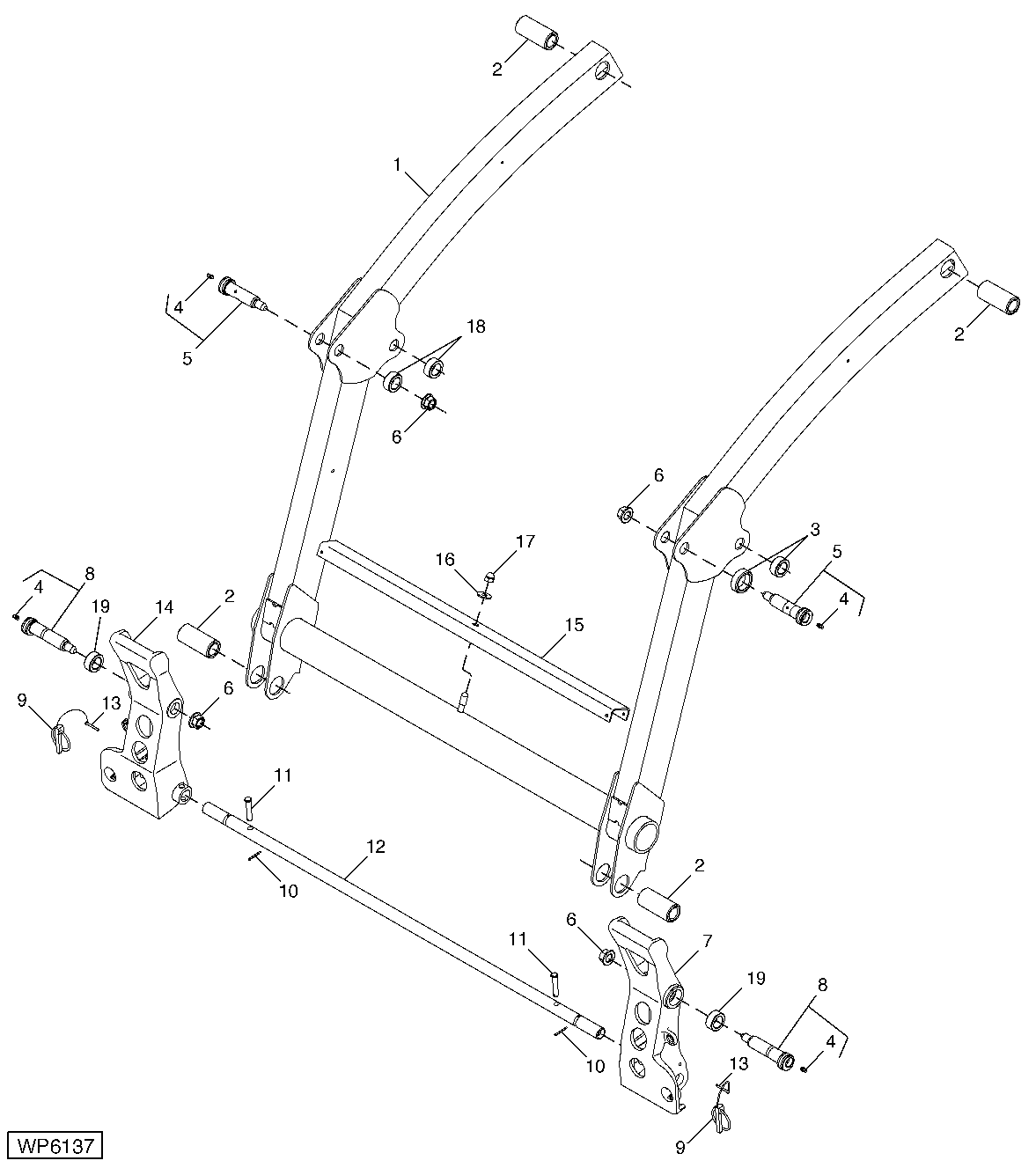

I've come across quite a few posts for the pins and hooks but I haven't seen what I'm looking for. Maybe I just don't know what they are called. Instead of the pins and hooks that attach to the buckets/forks or whatever else, I'm looking for the ends that attach to the loader itself which allows the for the quick-tach option. Any help locating these items would be greatly appreciated.

The loader side, or "Holder" as JDParts calls it, is available through JD for $87.00 each. #7 and #14 in the diagram below.
The part numbers are:
W50722 HOLDER (RH) ADD87.00 USD
W50723 HOLDER (LH) ADD87.00 USD

I sure do appreciate the info. When I stop by the JD dealer tomorrow, I'm going to take some pictures and measure the size of the holders. That way I can get an idea of the size and see what I'm looking at to see if the holder will indeed fit on my loader. Again, I sure do appreciate the information.
