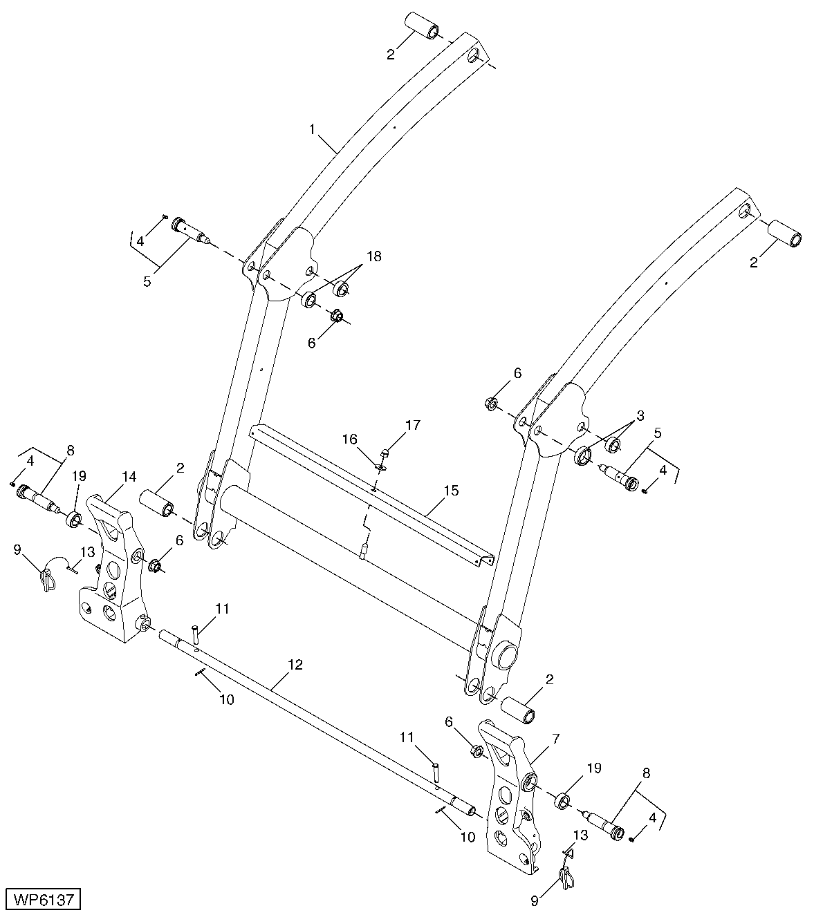

I've come across quite a few posts for the pins and hooks but I haven't seen what I'm looking for. Maybe I just don't know what they are called. Instead of the pins and hooks that attach to the buckets/forks or whatever else, I'm looking for the ends that attach to the loader itself which allows the for the quick-tach option. Any help locating these items would be greatly appreciated.
Are you talking about the skid-steer style (SSQA) or the JD style (JDQA) You have a Yanmar/CC correct?
/ Source for Deere Quick tach mounts #22
I'd be looking for JD style (JDQA) as I think my loader would be similar to the 200 series loaders. Maybe I'm wrong in thinking that there is a (QA) on the 200 series loaders. I was going to stop by a dealer Friday and see what they have.
Yes I have a Yanmar/CC.
I mentioned a quick-attach option to my dealer but he made the comment it would be to heavy. I've seen some aftermarket quick-attach options and from what I've seen they look to weigh around 80 pounds. So I figured if I could use the ones for the 200 series loader, I could possibly make them work on my loader. Although I'm probably wrong as the size for the 200 series loader is probably quite a bit different from my CL100 loader. If it isn't to far off, figure I might be able to fabricate something that would work for a quick-attach option. I haven't seen anything yet for the Sc2400 which someone might have made something and I just haven't found it, or is in the process but just hasn't come out yet.

The loader side, or "Holder" as JDParts calls it, is available through JD for $87.00 each. #7 and #14 in the diagram below.
The part numbers are:
W50722 HOLDER (RH) ADD87.00 USD
W50723 HOLDER (LH) ADD87.00 USD

I sure do appreciate the info. When I stop by the JD dealer tomorrow, I'm going to take some pictures and measure the size of the holders. That way I can get an idea of the size and see what I'm looking at to see if the holder will indeed fit on my loader. Again, I sure do appreciate the information.

You are welcome...But I thought all the Yanmar/CC tractor came with a QA on the loaders? Maybe just the bigger ones?
This is one thing no other manufacturer but JD has...a simple, lightweight QA setup for ALL it's loaders!
/ Source for Deere Quick tach mounts #26
It's possible that the larger ones do. I know mine doesn't have one and like I mentioned earlier, when I asked the CCY dealer, he said it would be to heavy. So it might be that the QA is available for the larger tractors/loaders.
