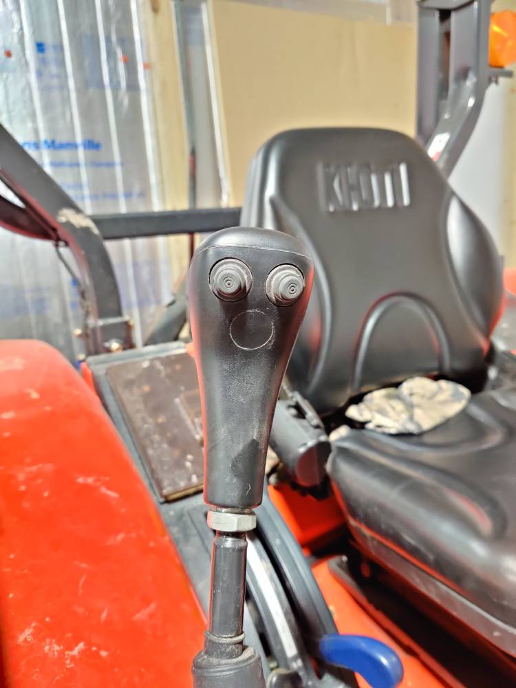

Just so you're aware, I'm not sure the Kioti brand is a "true" third function. I lose curl/dump when I open/close my grapple, so I'm thinking it's a diverter style. But...my experience with tractors isn't all that much, so I could be mistaken. I verified everything is installed correctly, because my thinking was that I shouldn't have lost curl/dump with a true third function. But whatever. I've learned to work around it.

Yup. I wasn't a fan. That's why others have modified the existing handle to add buttons and such. You get used to it after a while.
Not a fan of it either really. The nice handle it has(d) to begin with (the JD style) is much more comfortable. Really not sure why they could not put the open/close buttons the same place JD does and operate it with your thumb instead of first (2) fingers.
You do get used to it however. Still a PITA to switch between my tractor and the old mans.
/ Source for Kioti Branded 3rd function? #24
I agree. Especially with the NX model. They tout the ergonomic handle in all their literature and then if you want a third function they remove it and put on a basic knob? That's unacceptable.
What workarounds are possible? Justman mentions modifying the existing handle which I would be interested in. Or is it possible that the John Deere kit would work (not sure how similar the handles are)? Just looking for a way to keep my handle and have thumb operated buttons like you said.
Kioti's loaders are impressive and they tout that as a selling point as they should, but things like this and their crappy valve that eliminates the ability to do two functions at once (practically, anyway) kind of take some of the shine off of it. As someone considering buying a Kioti it's definitely not a deal breaker, but it is an oversight on their part.
/ Source for Kioti Branded 3rd function? #25
I'm reasonably sure some creative person with a bit of time on their hands could move the buttons from the ugly stick to the ergonomic stick...and then show us all how to do it!
I found it to be more of a "want" thing than a "need" thing though. I liked the ergonomic handle because it looked cool. That being said, I came from a JD2305, and the handle was a little black knob thing. The ugly stick with buttons is still better than what I had, and it works just fine.

You nailed my thoughts exactly. Handle is nice, it痴 great, and I hate that I would have to get rid of it. I feel like shouldn稚 have to... But the overall effect on production is zero.

Here is the handle I used Absolutely love the ergonomics, very easy to operate the 2 buttons with my thumb.

You should be able to buy a small rocker switch and install it in your handle. That is what I am going to try and do. I hate the Kioti 3rd function handle.

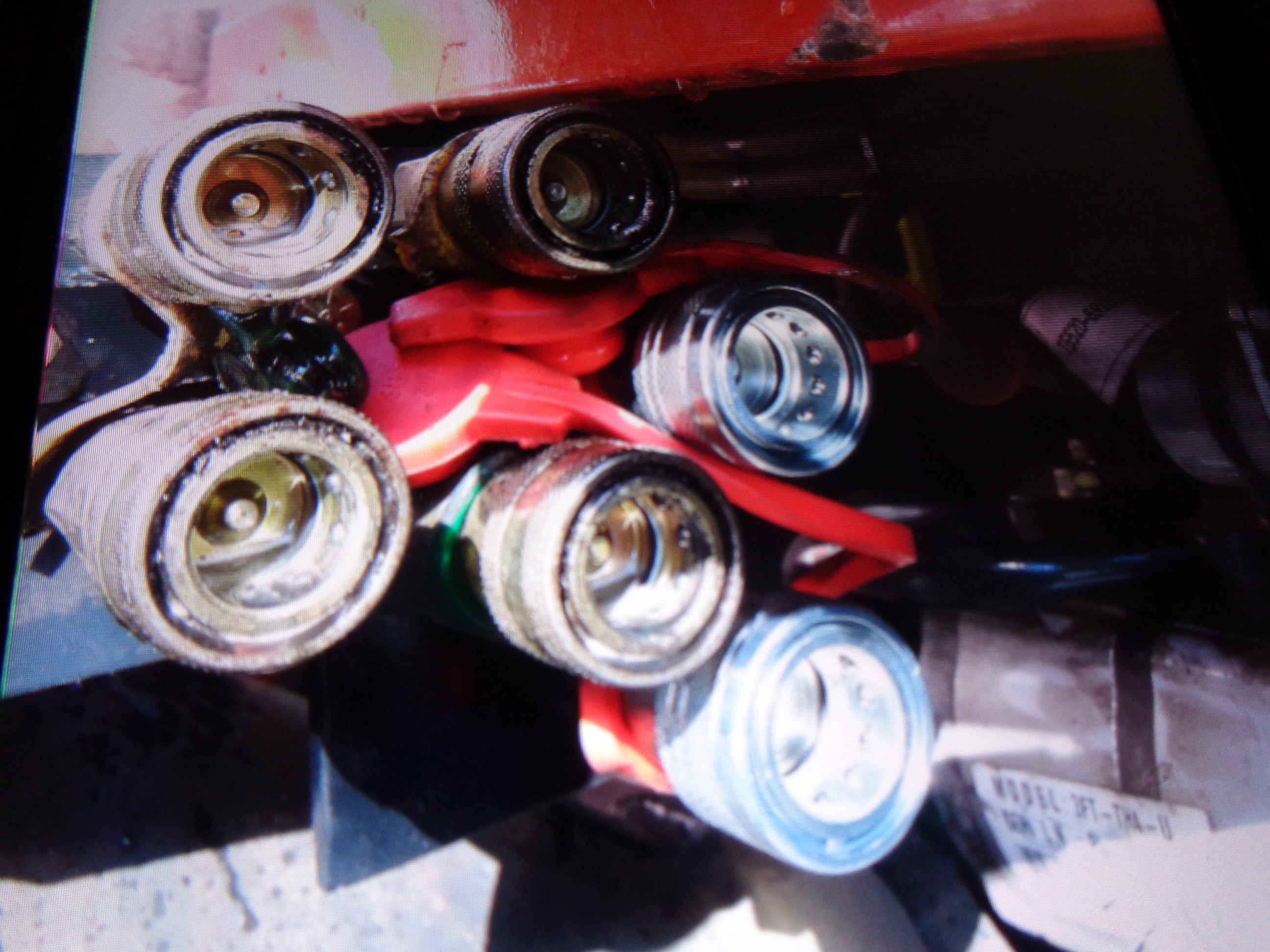

I decided to go the cheap route using the rear remotes. I bought my hoses from Discount Hydraulics and the fittings from Surplus Center. Total out of pocket was around $250.00. I don't see me using this very often and decided to spend the extra money towards attachments. I bought a stump grappel bucket and a 72" Skid Pro rock bucket. I made a bracket to attach onto the loader hydraulic disconnect bracket. My 3rd function disconnects will go there. Eventually I will make a front bracket for the grapple disconnects on the loader crossbar. I'm waiting for two reducers to come in this week for the grapple bucket hoses.

Loader disconnect bracket.
