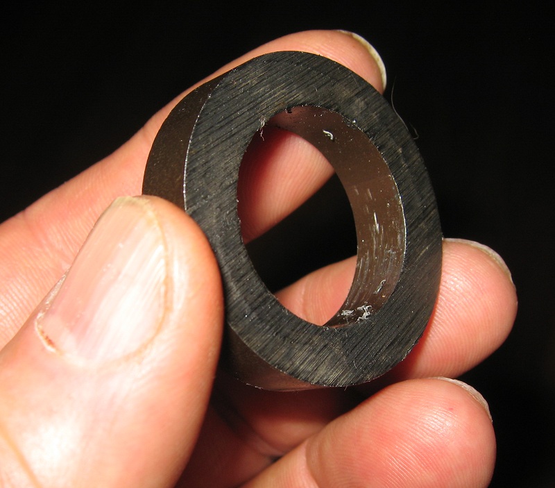

Search for DOM tubing. Dom tubing is sold by outside diameter and wall thickness. They don't guarantee the inside diameter so you usually have to ream it out to the size you want (a rat tail file will work for short pieces).
If you need a 1 inch ID order 1-1/2 inch OD with 1/4 walls. You might be able to find a scrap piece at a scrap yard or a local metal fabrication shop. The picture is a scrap of DOM tubing that I picked up off the floor next to my bandsaw.

Mars: Great Idea. The local steel supplier here has DOM tube. I'd considered trying to make these little things if I couldn't find something premade at reasonable cost, but hadn't come up with a simple way to do it.
