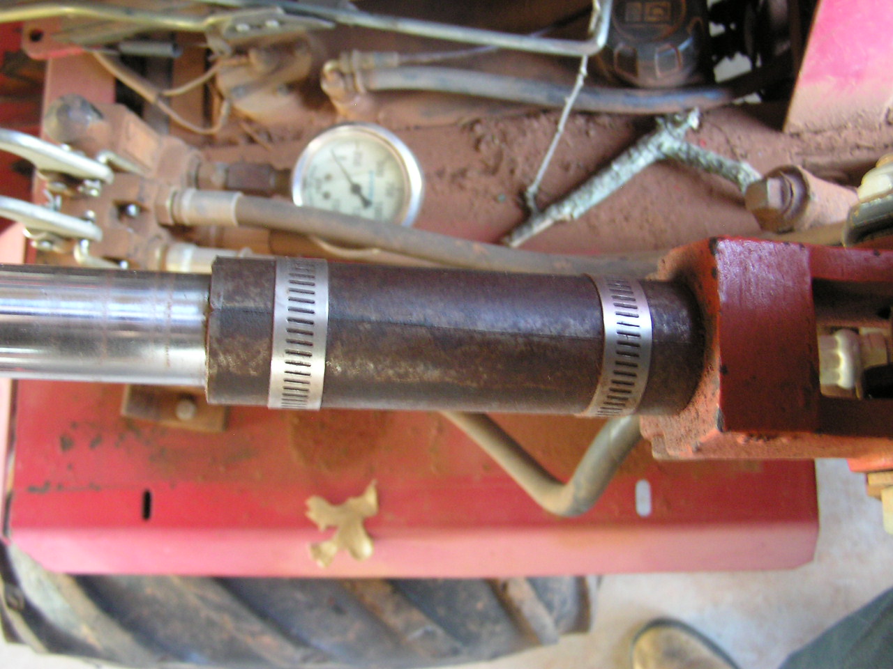

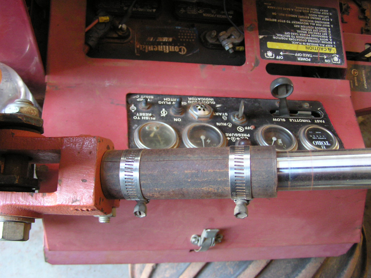

I made some by cutting thick wall tubing that had the same ID as the OD of the cylinder shaft. I cut them to the length that I needed, then cut them in half, long ways, to go around the shaft. They are held together with a hose clamp at each end. They do not slide on the shaft.
I think you could put tape or closed cell foam rubber under those from TSC, so that they would not slide on the shaft.

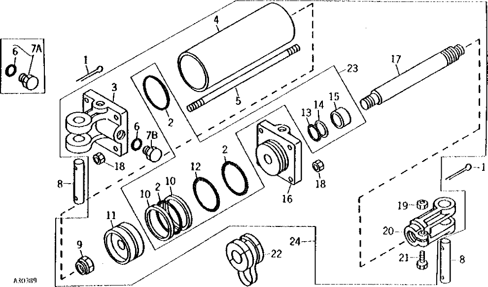

Depth stop doughnuts being rough on the inside shouldn't cause any problem unless cyl rod is pointing straight up. Any other way doughnuts should stay where they were placed on the clevis end of cyl rod. Here's some stops(parts key #22) you can get from JD dealer if you can afford them.
AA33111 Stop ADD 26.40 USD
AA33109 Stop ADD 24.13 USD
AA33110 Stop ADD 24.97 USD
AA33108 Stop ADD 23.30 USD

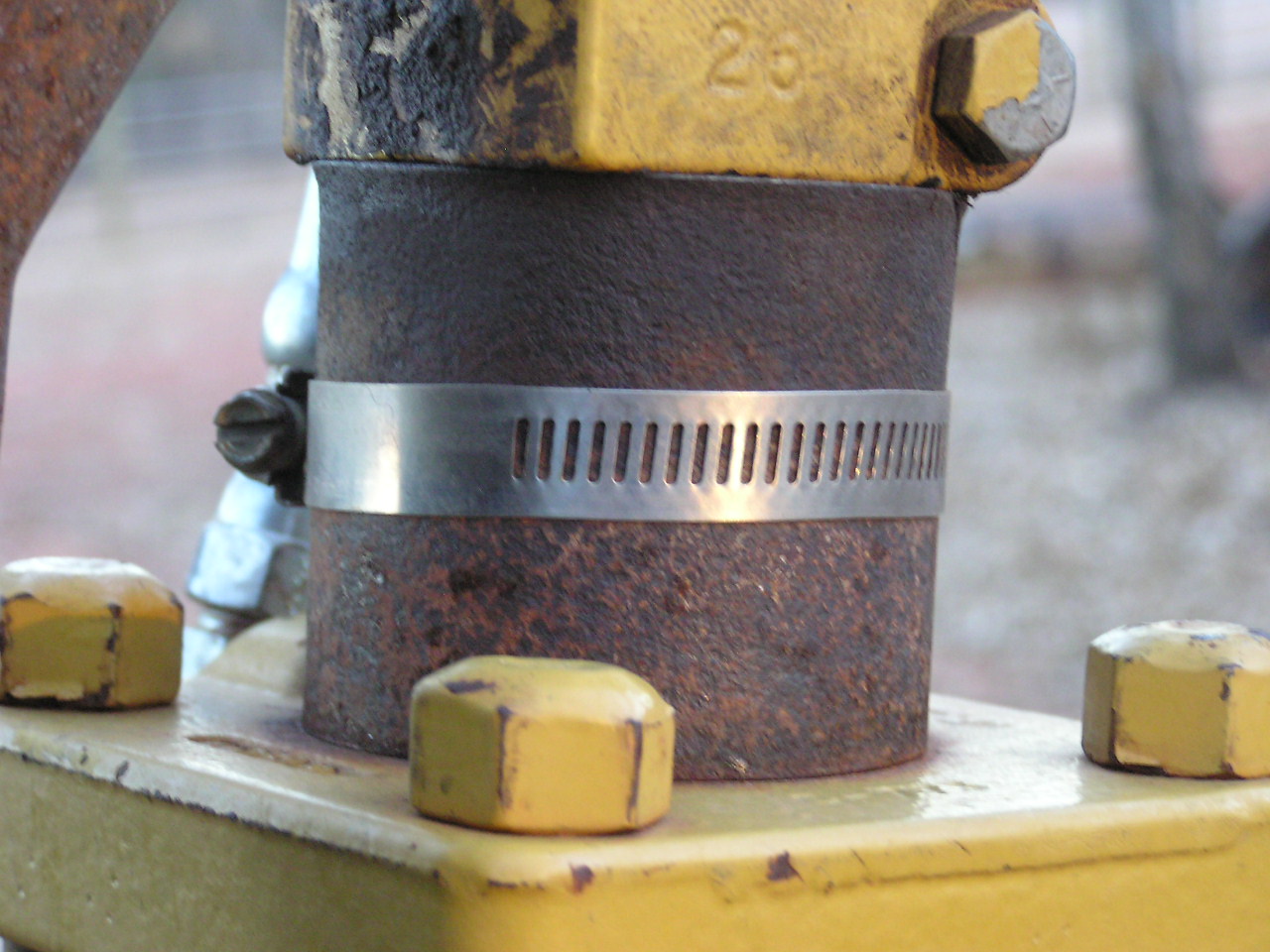

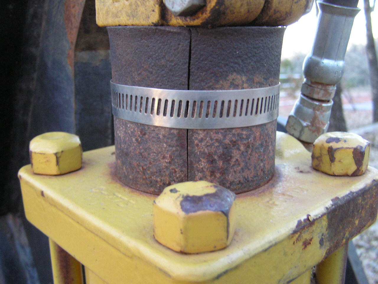

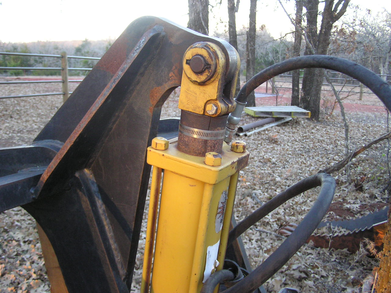

About three and a half years ago, I made this stroke stopper for the Gorilla Grapple, from a piece of 2 7/8" tubing.
Cut it to the exact length needed, then cut it lengthwise on the bandsaw. This one has a piece of rubber around the shaft, to fill the gap to the larger tubing. One hose clamp holds it to the shaft.

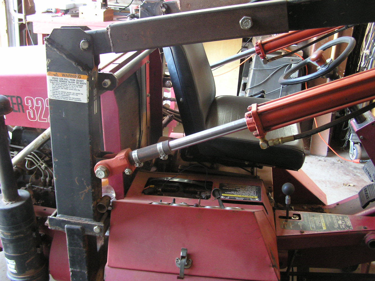

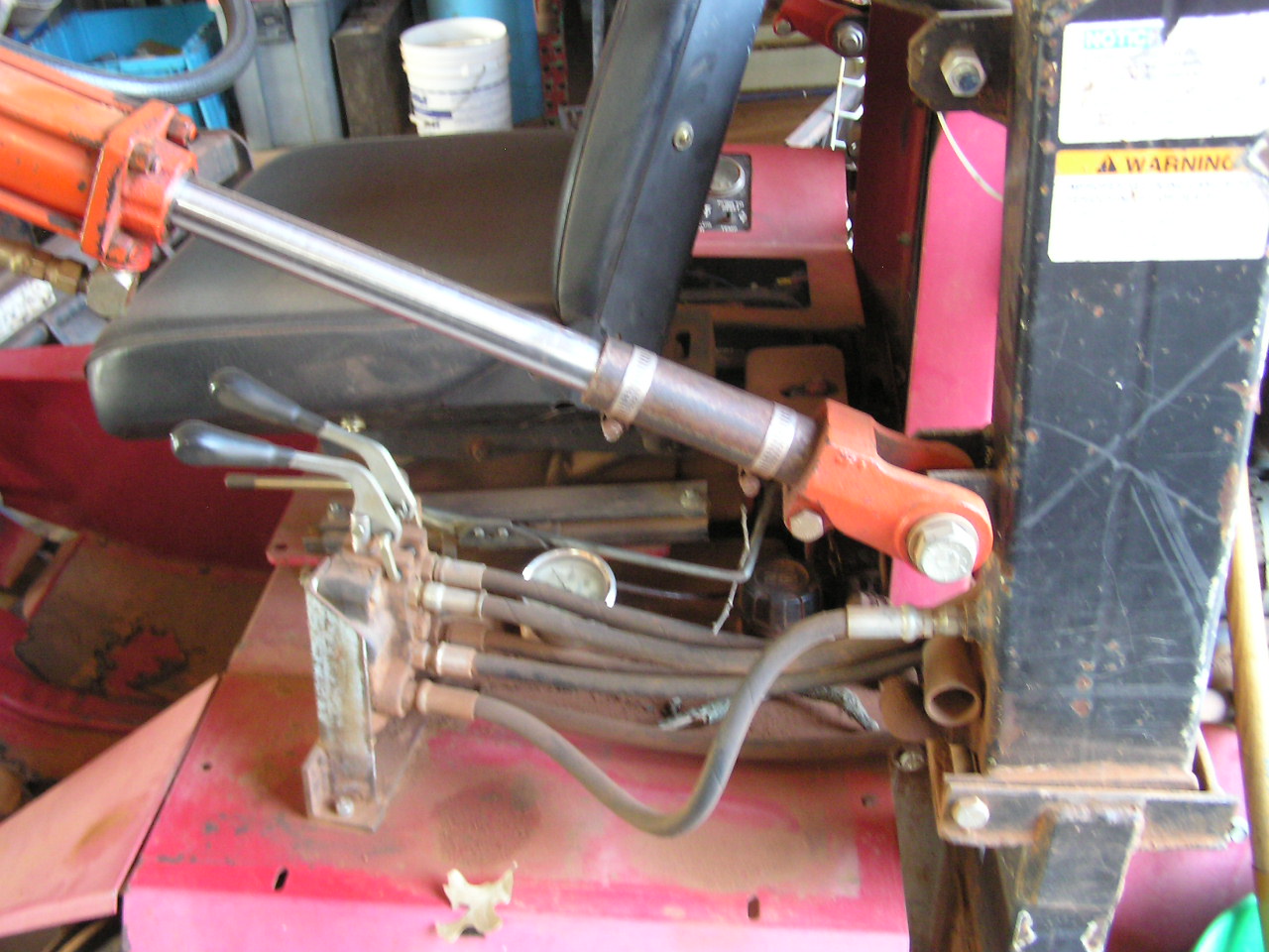

Thanks, I hope some future Lurkers and Newbies can use the idea.
These are a tight fit on the shaft.
