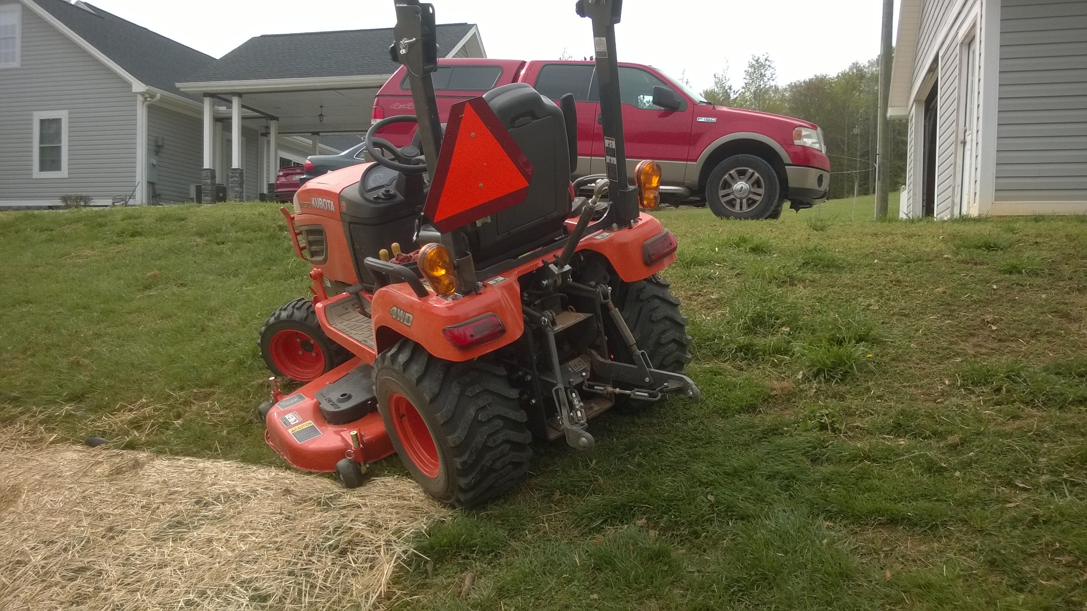

I have rear tires filled and side hill mow this spot. I know pictures aren't always great to show exactly comparing one property to another, but I have side hilled steeper than this at my other property quite a bit going slowly so I don't hit a bump or dip or whatever and the SCUT is still stable. This was my BX2370. I now have a BX2380 that for whatever reason feels even a little more stable than the 2370, but either one felt fine at this angle.
In this picture, I had just sowed more grass so didn't park the tractor side hill in the photo, but this is what I regularly mow every week.
SCUTs have 4WD and it makes a huge difference in ability to climb, turn, keep traction, etc. I used to have a JD L118 Lawn tractor and would have never side-hilled this and it's hydrostat struggled and spun on my lesser hills. My BX doesn't struggle or spin anywhere I mow with it. The difference between a gas lawn tractor and SCUT is not even comparable.
All that said, do not mow with your back hoe or loader on as they will very possibly adversely affect your center of gravity on the hills. I always remove my loader and whatever rear attachment is on before I mow.
