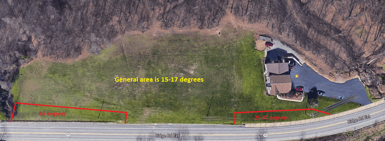

I have a 15 acre total size property with 3 that are grass. The general slope that we are built on is 15-17 degrees with steeper areas that are right near 45 degrees.

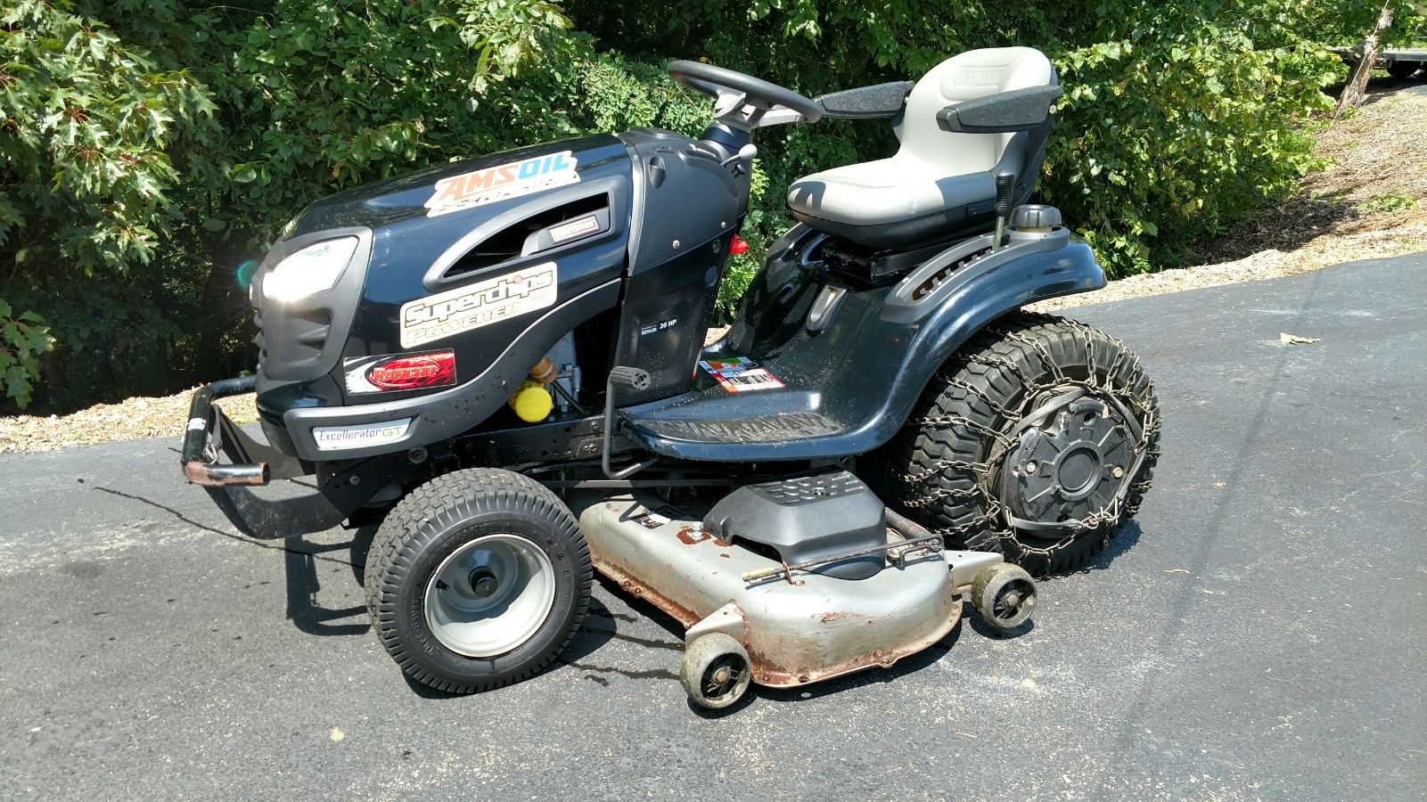

2010 Sears Excellerator GT - Arguably the biggest, baddest, and bestest tractor ever to set in a Sears store. This Husky built garden tractor is truly a beast, with a Hydro Gear 730 rear axle and 26 HP Kohler Courage, it has never ending power. But the engine is a Courage (not a contractor grade, rated EPA class C for 500 hours median engine life) and after 7 summers the transaxle is starting to give it up. Where this thing used to crush the hills at speed (8.5 MPH max speed, and it was close even up hills at first!) the transaxle is giving up a good bit of its power now when going up.
I run this Excellerator with the biggest wheel weights I could get, fluid filled rear tires, and chains. That allows me to get up the hills while mowing... often with the front axle bouncing lightly up and down as I balance my weight to keep it on the edge of a wheelie. My property has no flat ground :-(

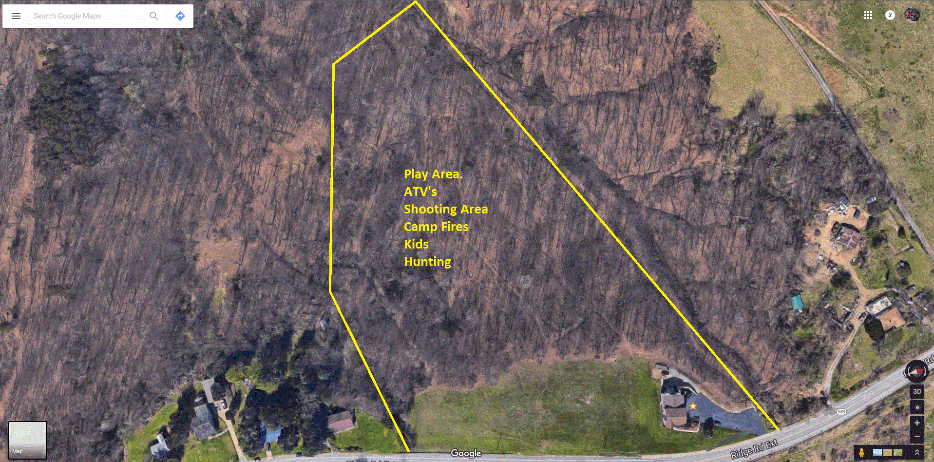

So my goals are to cut my 3 acres 1 to 2 times a week. I spend 4 to 4.5 hours doing this now with my wife on the tractor while I am trimming and push mowing the really steep stuff. The loader and backhoe are more for fun... I shoot on my property and can use them to fashion a better berm to shoot into. We have a camping area down back with ATV/Jeep trails and get water ruts that are tough to repair... with this maybe I can get down into the woods and back out using the R4 tires?

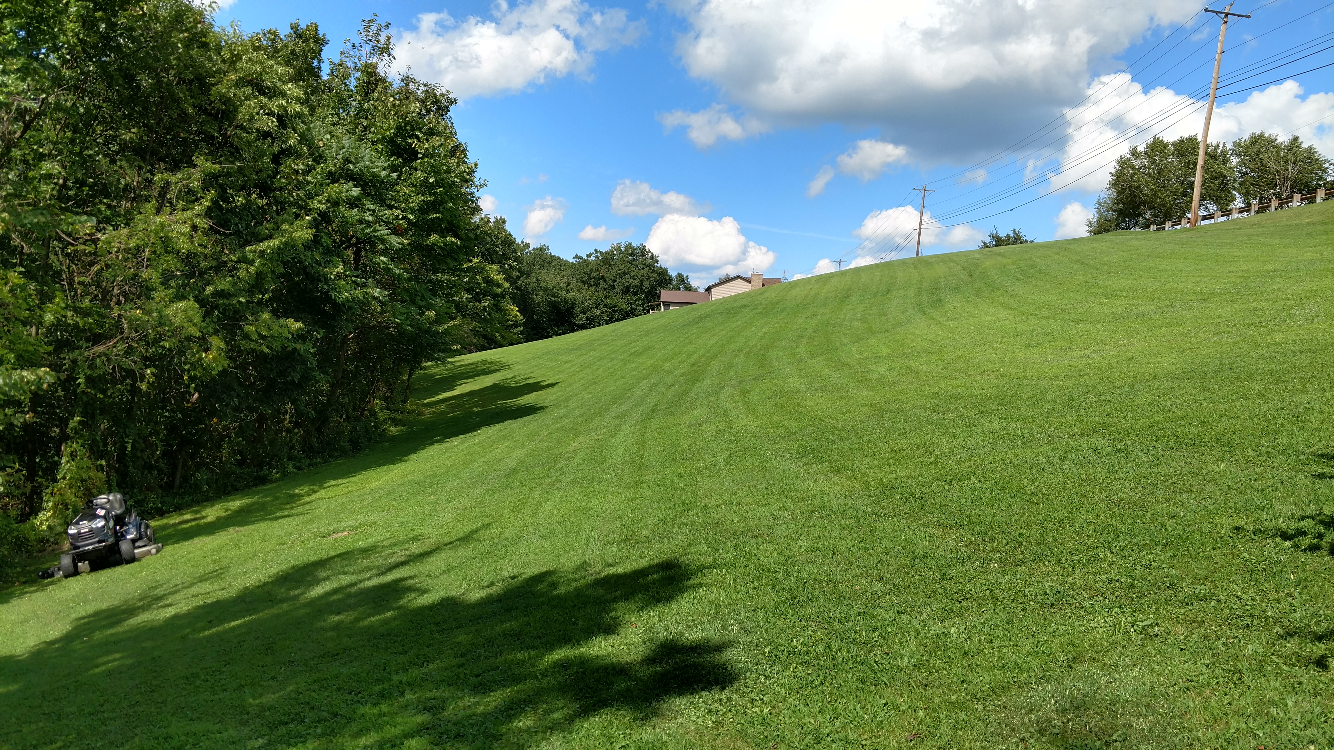

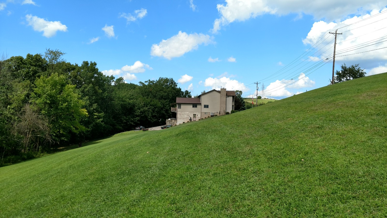

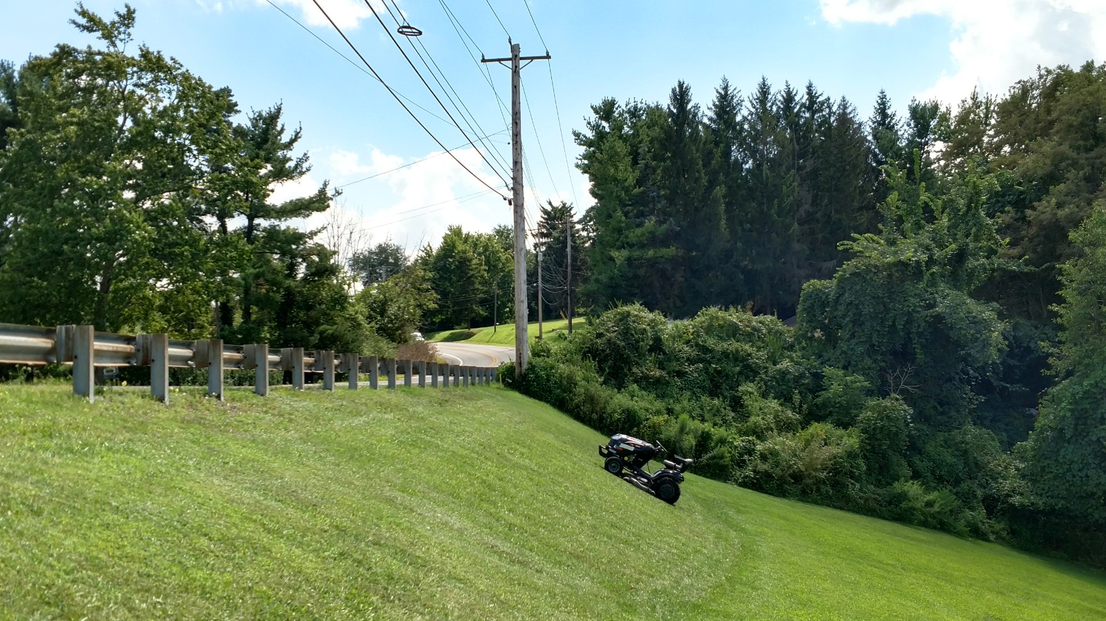

So I was out cutting grass again and used a digital protractor and the floor pan of the tractor to gather some more accurate data (I verified the step through floor as flat and level while setting in the garage). So the general yard slope is 16-17 degrees. Then I went to the steepest area that I was wrongly calling close to 45 degrees... and my eyes were deceiving me. It is actually 32-33 degrees out at the guard rail.
I cut the 16-17 degree part of the yard sideways as you'll see in the attached photos.
I cut the 32-33 bank vertically.
Seeing these photos, do any of you SCUT owners feel that you would be safe and comfortable cutting my yard side to side at high speed?

I'd feel very comfortable on my BX mowing that. Much more than my old Craftsman or JD lawn tractors. Filled tires help too. I'd be perfectly comfortable side-hilling all of that except maybe the bank. I might try it down low though. Either way, the hydro on a SCUT is nothing at all like what you've used before. That and the 4WD will make you a very happy camper.
