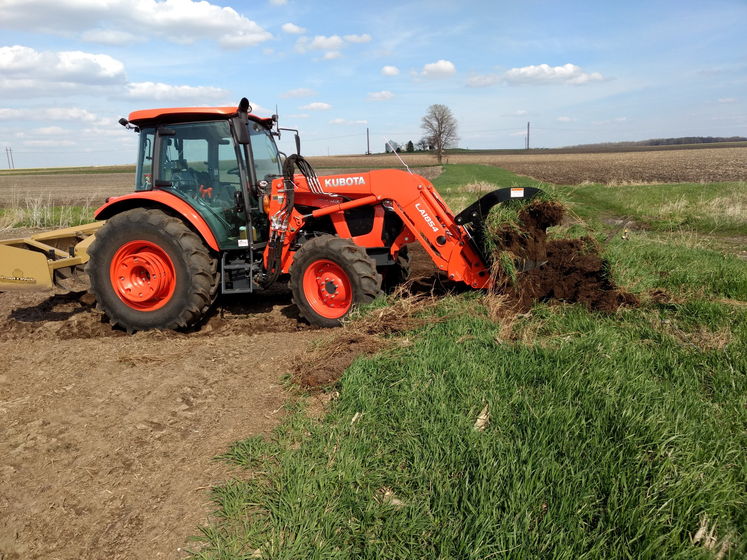

I have a Land Pride BB3584 I used it behind a [AFFILIATE=1, nofollow=true, newwindow=true, title="Kubota"]Kubota[/AFFILIATE] M7060, now I use it behind my M5-091, it's a very good product.

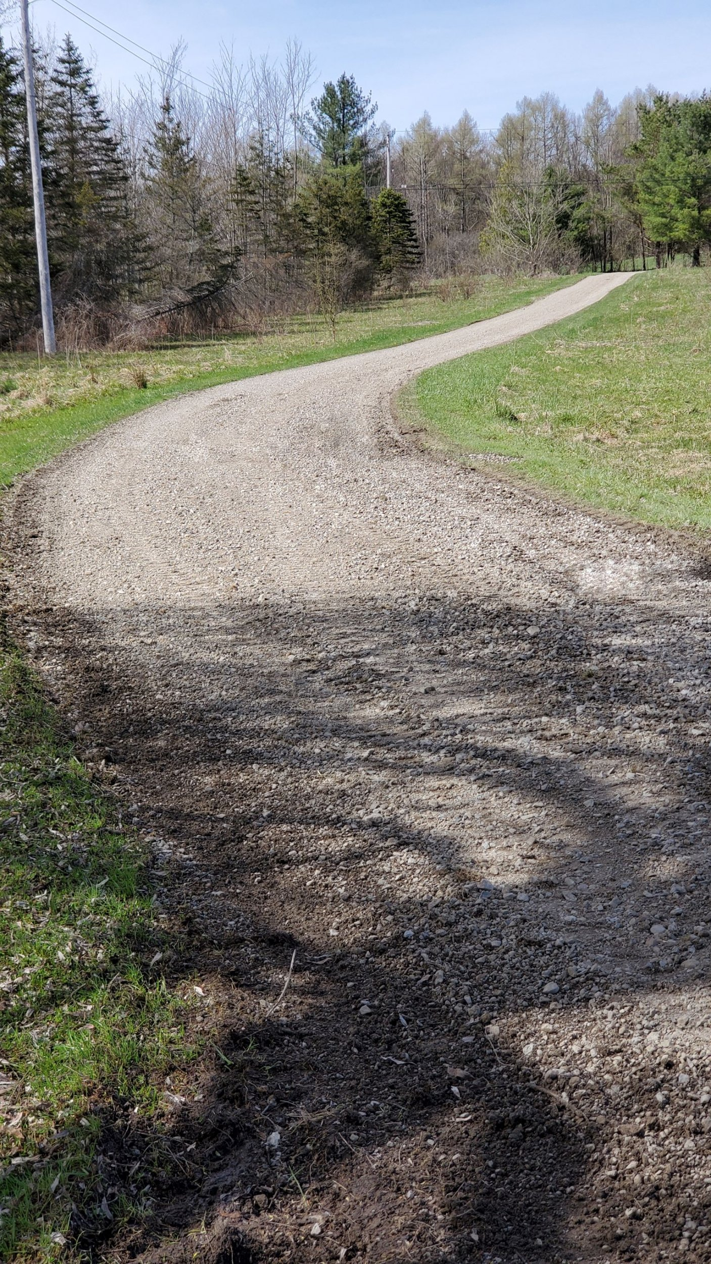

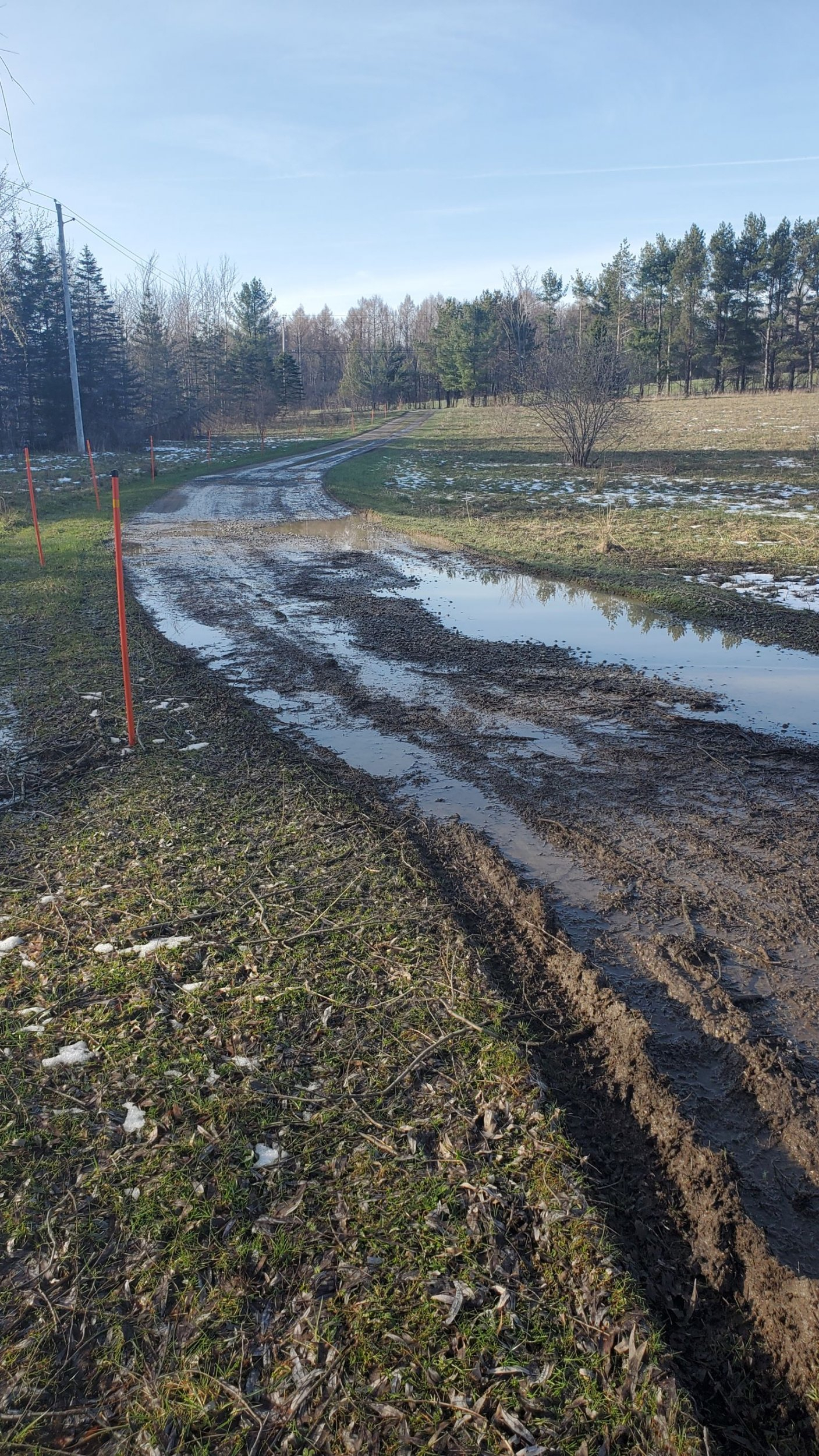

I have both a 72" Frontier box scraper and a 48" Land Pride land plane. Both are built very well. I used the box scraper for years to maintain my driveway. Once I bought the land plane, I almost never use the box scraper anymore. I found the land plane is a far superior tool for grading my driveway.
If you want to pull gravel and spread it, then the box scraper would be a better choice for sure. I'm sure I'll hear from the folks that say that they can do just as good of a job with a box scraper. Yeah, yeah, yeah, blah, blah, I'm happy for you all.
This was my drive after winter. After she dried up, this was just a few passes with the land plane. I did not add any fill.
Just giving you options to consider.
