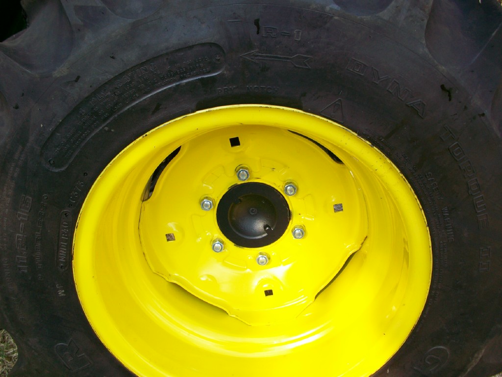

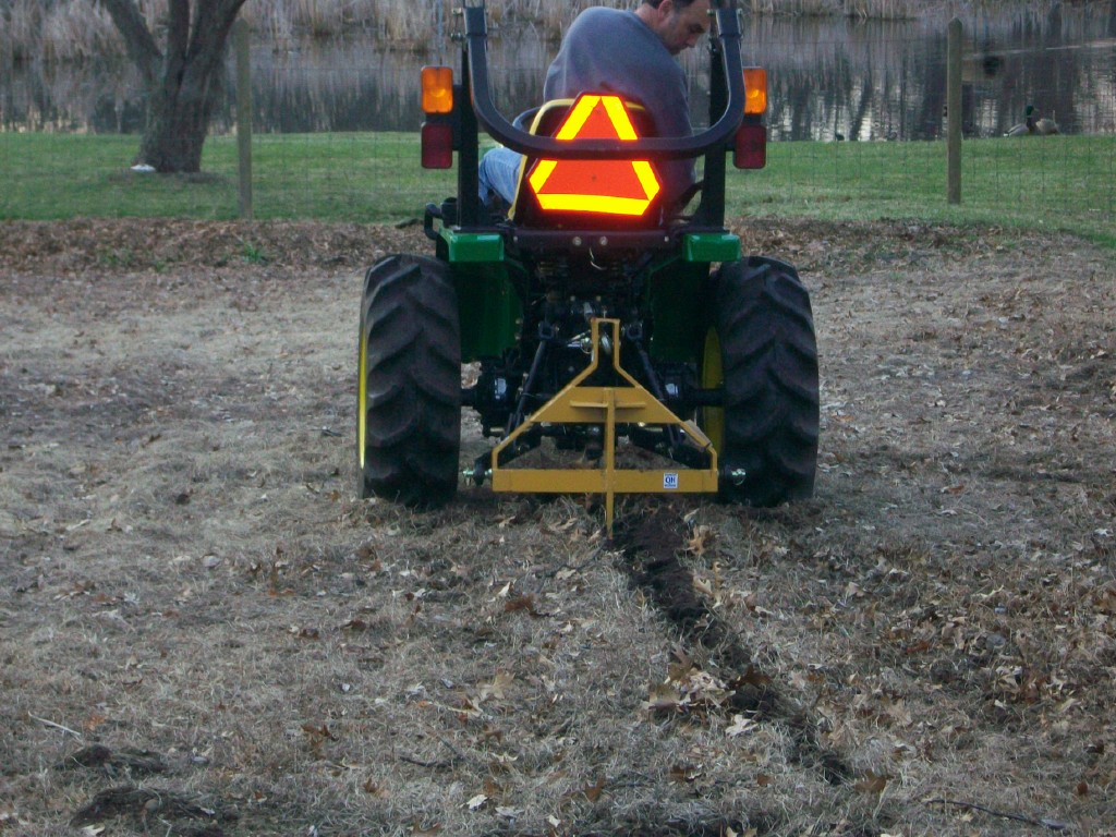

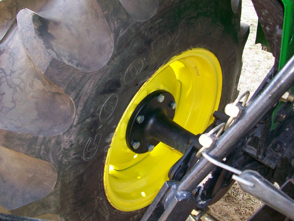

Just wanted top update this thread. I bought some grade 10.9 bolts of the correct size and tread pitch, and some correct tapered lug nuts. I installed the bolts from the back side of the axle flange and torqued them to the specs listed for my original lug bolts. I also used blue lock-tite on the part of the thread that is in the axle flange. I then torqued the lug nuts to the same specs. The wheels/tires are 1" wider farther out on each side to the outer sidewall than the original R4's. The inside edge of the fronts line up nicely with the inside edge of the rears, which is nice for pulling a plow when the wheels are in the furrow. I will be checking the torque regularly for a while until the lug nuts take a permanent set, especially since the rims were NOS with paint still in the taper where the nuts seat. I got to use the new R1's today while pulling my subsoiler in a neighbors garden that has developed a pretty good plow pan over the years. I was able to pull it full depth. It is one of the TSC full sized SS's.

   / Spacer/rim position Q #25
Looks much better, and I'm sure it feels more stable now.
#26
Thanks.
To be honest though, I have never felt unstable on it. That was not my reason for the using these wheels/tires. It is just something I have to accept (or benefit from) due to the rims offset that came with the tires. I made the swap solely because I prefer the R1's. Loaded with RG, they make this little tractor pull like a much bigger machine.
