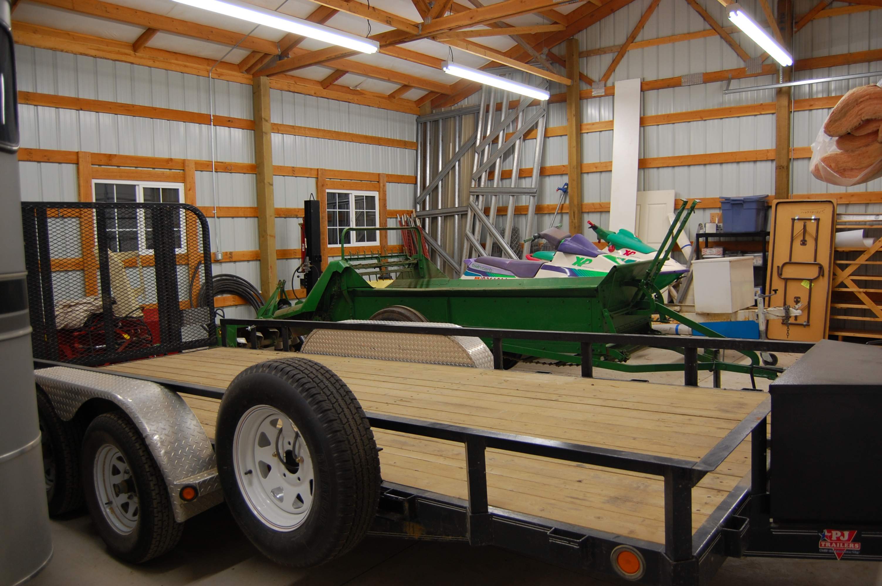

I mounted mine on a bracket i welded to the side rail of my trailer. hasnt goten in the way of anything (yet).
That is where mine is on my trailer also. It has only gotten in the way once in 8 years when I was hauling a 10x10 Hot Tub. We simply took it off that time and put it on the bed with a ratchet strap. To haul the Hot Tub we layed old carpet on the rails then put 4-5 pieces of pipe down then the Hot Tub was loaded. When we got it home we backed up the trailer to the deck and jacked the trailer up to the level of the deck and rolled it off and in place by leap frogging the pipe. Worked great.
This was all before we put the rail on the deck.
Chris

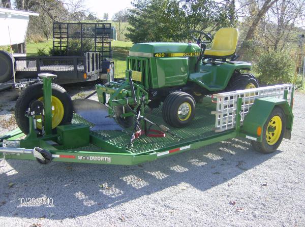

Mine sets on the right front on my 16', on an upright on the tongue on the 10'. ~~ grnspot
