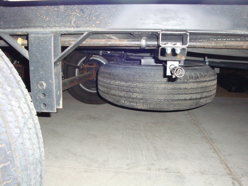

I have a 20' car hauler(no sides) looking for ideas on where to mount the spare tire. I have a tool box on the tongue behind the jack, maybe make a raised mount? Currently have the trailer torn apart and fixing a cracked frame and putting new floor in it. Any ideas or pics?
thx
   / spare tire mount?... #2
PJ trailers has a spare tire mount that slides into any of your stake pockets. This allows you to place your spade tire just about anywhere.
   / spare tire mount?... #5
i prefer underdeck. I didnt want mine mounted to the side due to the amount of side loading i do. dont really have room in the front due to toolbox.
   / spare tire mount?... #6
Get a spare tire winch mechanism from underneath a dodge caravan ( mini van ) the cost will be around 20.00 from your local salvage, or they can be purchased new from dealership but will cost close to 100.00 ..... bolt the winch just inside the trailers box frame allowing enough from the edge to accommodate the tire size, to a cross member rail anywhere under the trailer, You may want to add an additional pc across higher up closer to the decking to obtain more clearance, this would depend on the trailers actual height, Oh! and be sure to get the crank rod that matched the spline shaft of the wench,

I have been looking at this way to mount it. I think my trailer is to low to the ground to work. I run a real short 10 ply 16" tires on it, not the standard 235's. If my measurrements are correct my spare would hang a good 4-6" below the axle tube. With all the pastures and off angle ditch's I cross, I dont think this would work on this trailer. I do like this idea the best. I too do alot of side loading and do not want it mounted on the side. I never have really loaded with overhang in the front so I think I am going to mount there using a 2" square receiver setup. that way I can take the spare mount off and throw in back of truck if I need too.

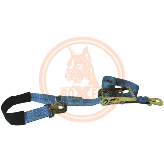

That stake pocket D-ring would be great for tying down cars, for example. I rarely use chains or flat hook straps unless its for equipment and pallets.
My flatbed trailer only has 4 d-rings and they're never in the right spot. I usually hook to the stake pockets, but with the car straps its not ideal and pulls from an odd angle.

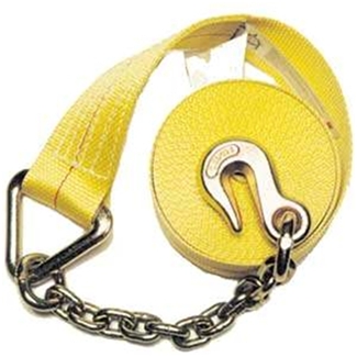

The stake pocket D-ring conversion looks like a handy concept, and would work great for light duty tie down, However looking at the design and the way it would be secured inside by a through pin would either mean having to drill a hole through the stake pocket or either the pin would simply go through under the pocket, only have the 2 ends of the pin holding in the D-ring insert from pulling back out, not a good idea, ..
For the most part the Stake pockets do well for securing light loads, I know we all can testify on how we have tied our equipment down to them, although is not their intended purpose , they are To install Side rails, So the pocket themselves are not welded in with the intent of securing heavy things/loads to,... With only having a couple of light beads down each side it scary to think about,
Example: Look at the weld, then look at the inside of the pocket where it is against the trailer frame, You see no weld there, I've actually removed stake pockets by simply a 1 minute grind of the weld on one side and hit the pocket with a 2 lb. hammer to knock it rest of the way off,.... So in sense of what I'm saying, if one weld were to break the other side will sure to fallow and break off,
If when planing to use the stake pocket as a tie-down point for our heavy equipment it would be wise to have them welded stronger or perhaps on the inside as well,
There are other options of tie down tools, Like getting a short link of chain with a hook on one end and a ring on the other, these can have rather versatile uses, go through the stack pocket reaching down to the frame of the trailer for a more trusting and secure point,
Not at all knocking the design of the stake pocket D-ring tool, I just feel like before using one perhaps be sure what your using it in is strongly secured, ;)
