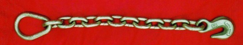

Sure people can (and people will) bust anything. Someone could break that short chain in the linked picture too, if a person tried hard enough.

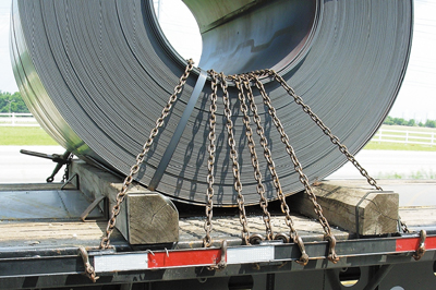

Stake pockets are desinged as tie downs. That is their main function. Look at every semi-trailer flat bed and see how equipmnet is secured to the deck let alone steel coils.
