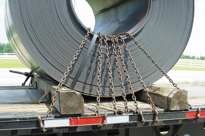

Stake pockets are desinged as tie downs. That is their main function. Look at every semi-trailer flat bed and see how equipmnet is secured to the deck let alone steel coils.
