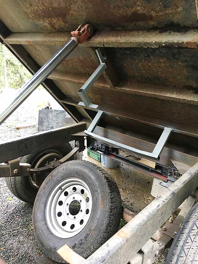

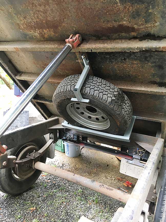

Just some pics of a spare tire mount that I built.
This trailer's pretty high, has space for a spare under the dump bed.
621702d1568766033-spare-tire-mount-under-dump-img_6638_12-jpg
621703d1568766033-spare-tire-mount-under-dump-img_6642_12-jpg
621704d1568766033-spare-tire-mount-under-dump-img_6643_12-jpg

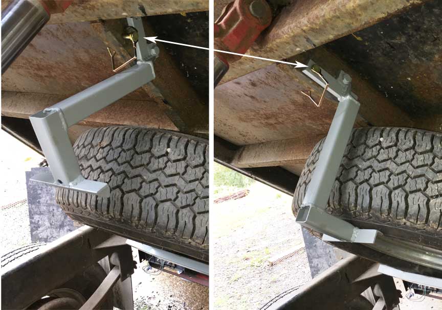

A hitch-pin holds the tire latch in place.

What happens if you have a flat while a full load is in the bed?
   / Spare tire on underside of DUMP trailer bed #4
Looks like you crawl under and pull the pin. I mounted my spare under my car hauler really nice and out of the way, however I used a crank down spare tire mount from a pick up truck. The crank handle is mounted in the tool box on the trailer. I also made sure and put the access on the right side of the trailer just in case I needed to lower it while on the side of the highway. The less time I have to spend near the driving lane the better.

Excellent idea but you do know that nice looking tire and rim will soon look like it was submerged in a river for a decade or two !! Wrap it in a couple industrial bags maybe?? I know my underside spare rims get reeeaaalllyy rusty.

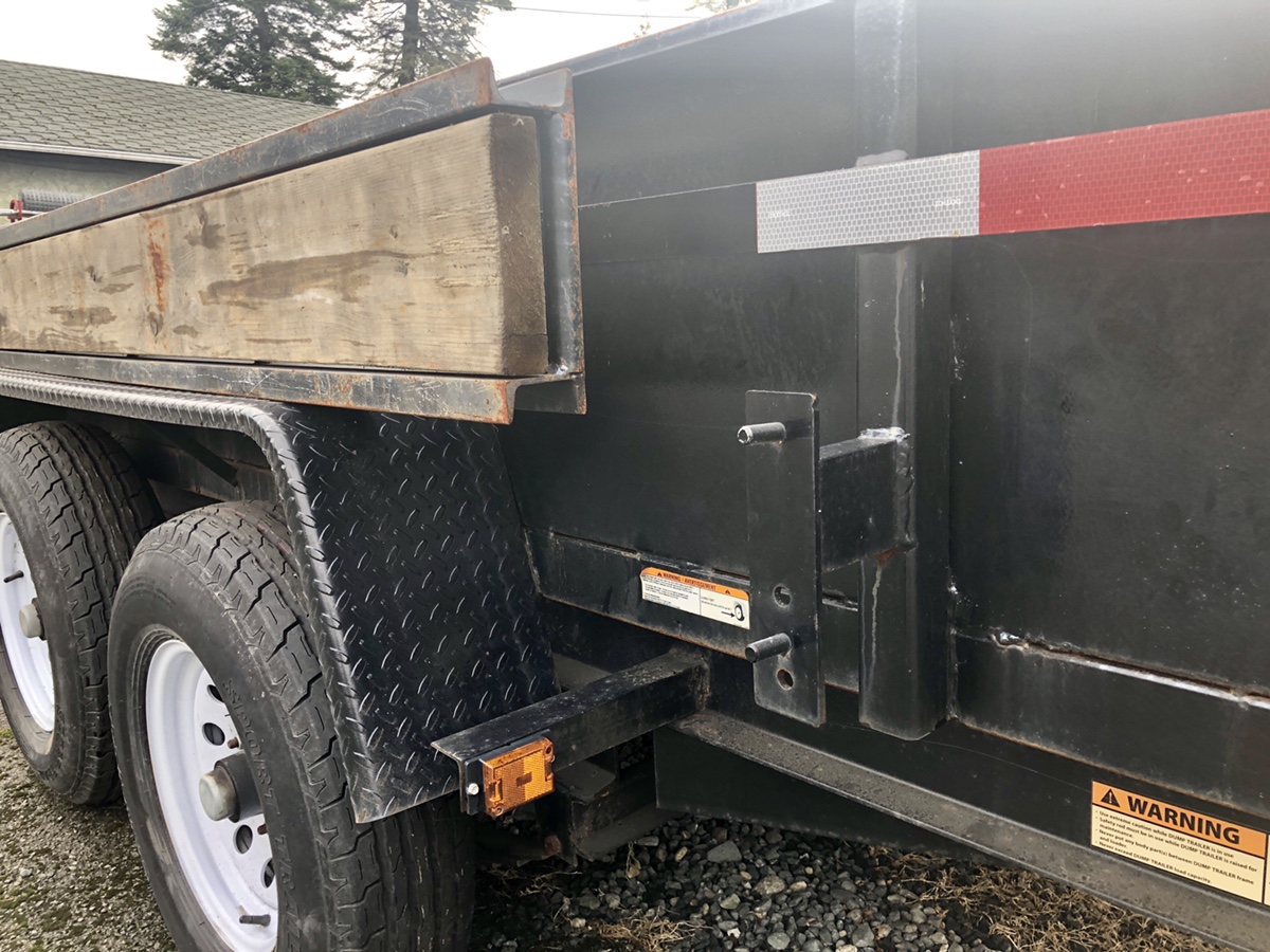

Nice job. I checked mine (Loadtrail 10k) it has a crossmember exactly in the way of where the tire would go. But it has a spare mounted on the side anyway.

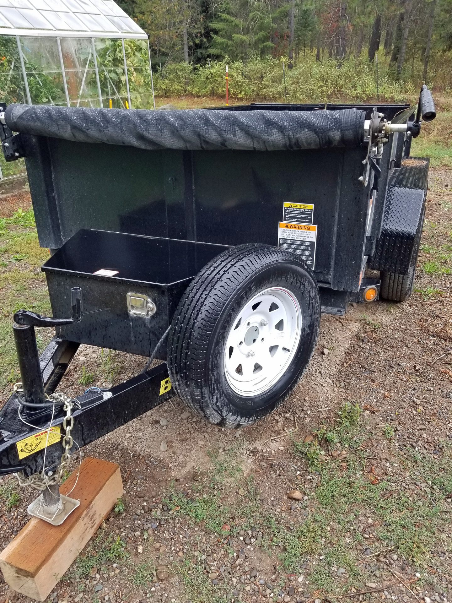

Mine is side mounted also.
