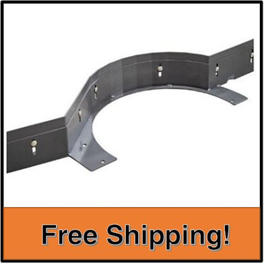

One of Spartans problems was deck baffles being a tad short. They offer(ed) a “turbo flow kit” which pretty much resolved this issue. From your list, I’m guessing you checked the spindles/bearings also.
Found it;
Jul 6, 2020 — Spartan Turbo Flow Kit creates more suction allowing for much cleaner cut.
