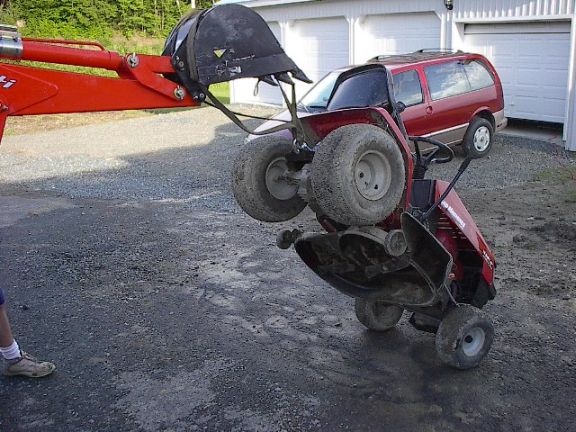

This is what I do /forums/images/graemlins/wink.gif. G
