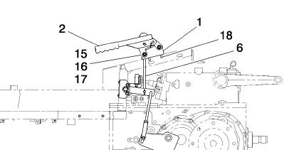

NH parts lists the handle with ratchet as part #86543759
Item #2
Item #2
I believe this parking brake configuration is different from my TC45DA (no Cab), which has a small lift lever to engage the ratchet pawl. I think part #86543759 is an upgrade that comes with the Cab package, and I am not sure that it even has a similar ratchet design. Does anyone else know how different the Cab and no Cab versions are? I find it difficult to interpret this schematic. If you go to the NH internet parts list you will not find any mention of parking brake for the no-cab versions of the TC Boomers.

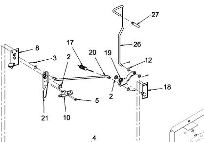

Non cab tractor. Item #21 Part#86403591

Thanks Inspector507! This is it, and the culprit does appear to be the 'ratchet pawl', part # 21. You must have access to something more than I can access at NH's web site. I am hoping that julichris can weigh in and tell us if this is what was purchased, at what price, and how easy or difficulty that repair is.

I got it straight off of NH's site. It wasn't real easy to find though. It's in the transmission section, then under the Brake listing.
