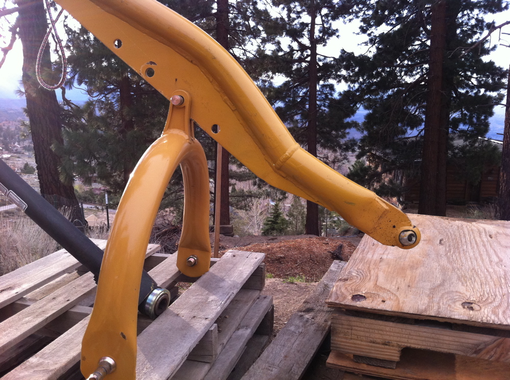

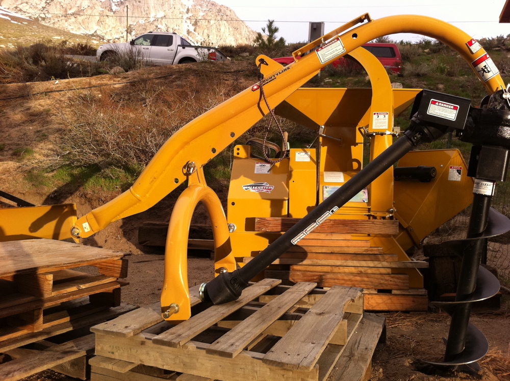

RanchHand,
Well I have been hanging around here for a long time, so I figure that if I can offer any help, now is the time.
I know exactly what you are looking at, as I too purchased a Countyline PHD for my JD 2720 ( the same tractor as a 2520 except 31 hp)
last summer. When I installed it, I became very frustrated :mur: trying to achieve sufficient clearance for transport around my property. It just looked like the geometry was wrong for the tractor. I finally bit the bullet and modified the boom to approximate a straight line with an offset. ( my wife says I've never bought anything I didn't want to modify). You can see I cut a wedge shaped section from the boom, heated the rib and bent until the gap closed. Then welded back together and painted with Cat yellow. Additionally, I remounted the top link holder so it would not interfere. I can now get about 15 to 18 inches of clearance to the tip of the auger.
I really did not want to return the PHD to TSC because it's a 200 mile drive from my location.
Good luck.
Russ
