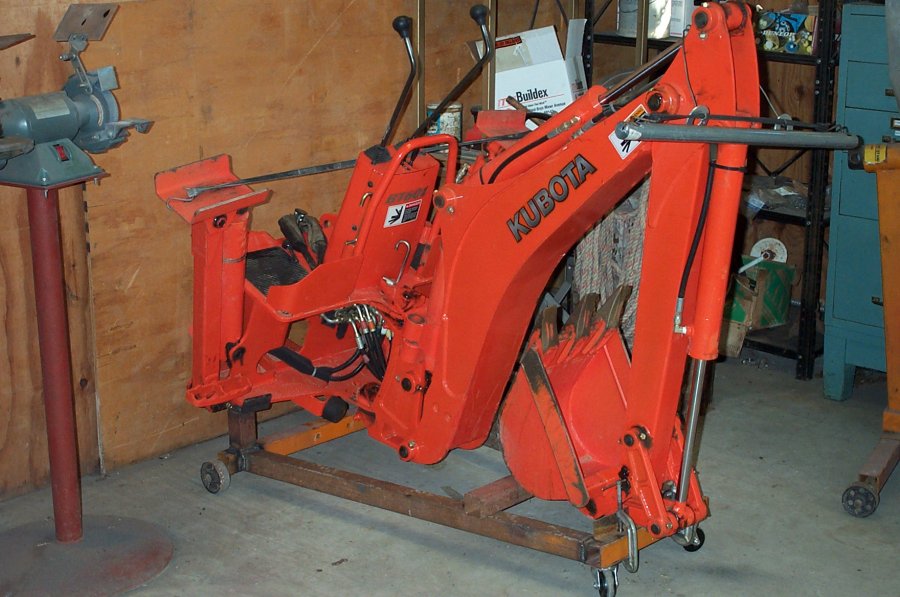

Even for an unpracticed, mere mortal like me, the BXpanded Dolly makes BH removal, storage and re-attachment faster and easier. I got mine about a week ago and love it.
Dang right ! For me the best part about using a dolly (like BXpanded's) is being able to store the BH ... and even if you are only removing the BH for a short time, it makes the process much easier. I didn't purchase mine from BXpanded, I have the skills and equipment so I built my own. ;)
It's not 100% finished, but almost

thats odd .. mine sticks on the left side too. i put grease on the pins and it helps a little. not a lot but something is better then nothing. i am so tempted to grind out the pin socket, but i keep telling myself - it must be something i am doing wrong. I wonder if it a certain batch of the BH made with the left pins sticking?

Radioman - I've run into that on some BH's. I use a flapper wheel in a die grinder to only remove the paint in the pin bosses, that does the job well. I have't had any that have been a pain once the paint is removed. You don't have to worry about the pin bosses like you would for your bucket as these are stationary. Just don't egg out the hole and you'll be fine (that would take quite awhile with the flapper wheel).
Now if you have used your BH enough and the paint is already gone.....then your on your own.
   / Speedy BH removal #20
Sticky left pin here too. Grease didn't help. The right one comes off like I know what I'm doing. The left one then needs a little adjustment. I've found that the aftermarket pin removal tool works.
BTW, the pin removal tool is a couple of taps on the pin with a hammer.LOL:p
