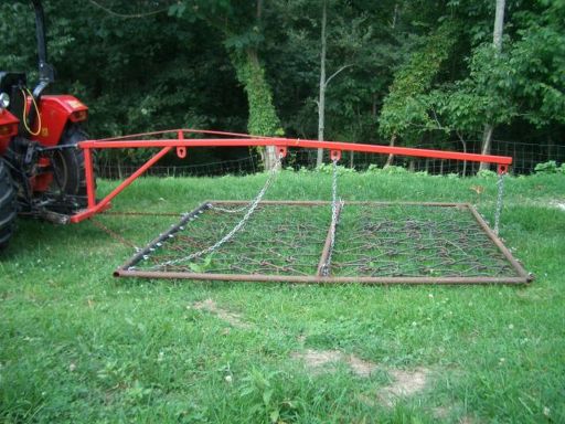

rambler said:
I've never used a chain type, but I think it would plug up a lot with the crop trash
That's why I framed mine so I could lift it with the TPH. Simply picking it up drops about 95% of the accumulated trash. I took advantage of the "accumulation" issue one year, and used the chain harrow to rake up several acres of brome sage seed heads. I towed it in decreasing revolutions around the cut area, depositing the accumulated seed heads at the same point on each pass. Ended up with a nice long row of accumulated seed heads to burn.
//greg//
